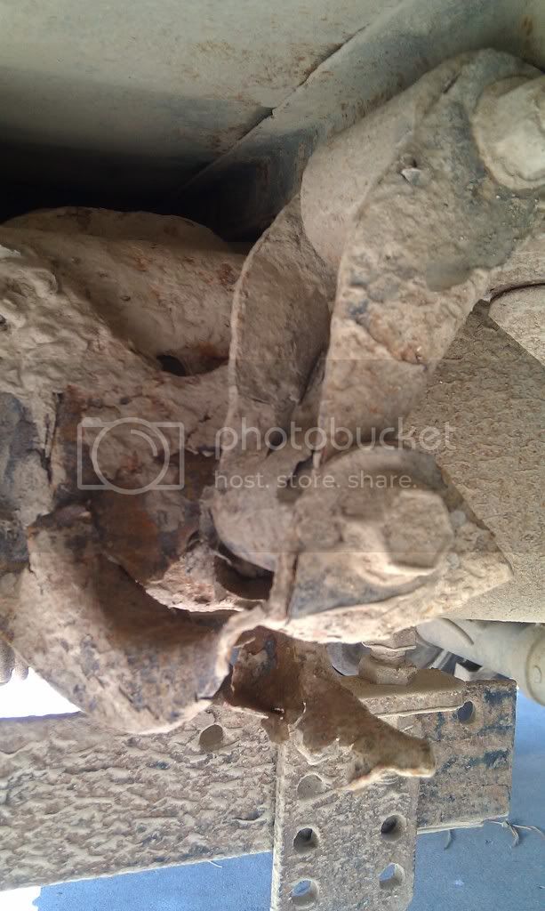

Anybody ever broke one of these? Where can I get new ones from?

Yep, those things come apart all the time in the north. They will run $30-$50 a piece depending where you go. NAPA, Ford dealer, suspension/spring shop should all keep em in stock.

yep been there broke that 85 bucks for both sides at napa break out the 4.5 inch grinder and go to town it took me about 1.5-2 hours a side taking my time

when you do it make sure you bolt the shackle to the spring before you bolt the shackle to the hanger or you wont be able to get the bolt in and it will bottom out against the hanger

I ended up going with a NAPA one and replaced it over the weekend. Not the most fun thing to do with 16 years of salt and gravel dust under there. Thanks for the help guys!
