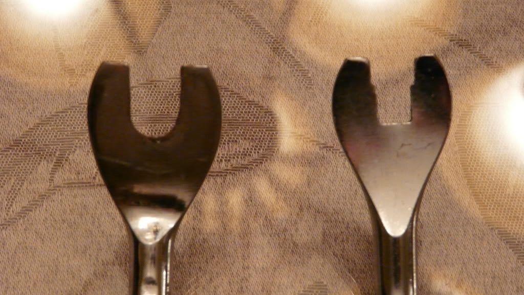

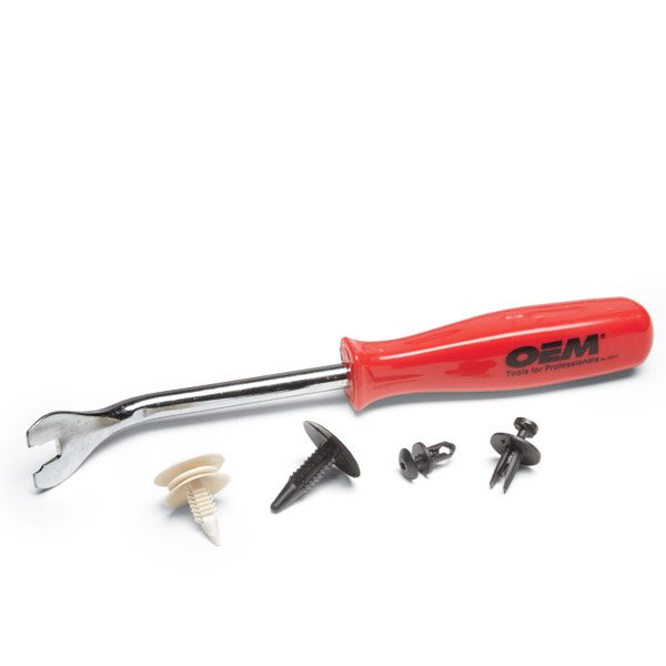

You can make a HPOP hose QD tool buy grinding out the square notch in a body panel removal tool into a u shape that fits over the QD fitting of the HPOP hose connector. Super easy with a round file or dremel type tool. See second pic for the before and after mod to the tool
Here is what a new one looks like in full veiw before mod so you will know what to look for at the chain auto store which they all carry it for under $10
