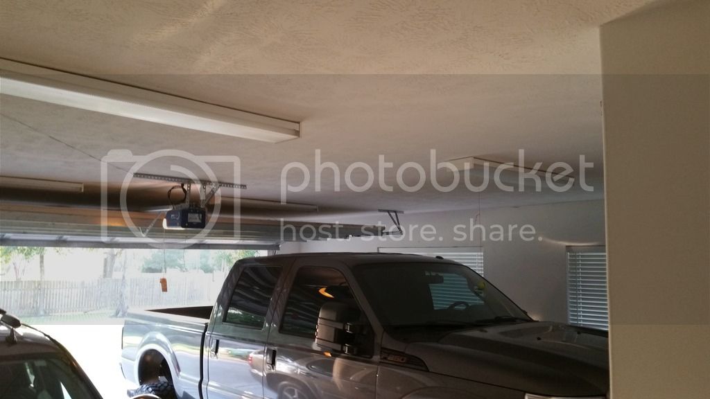

I'm running a 10" lift on 24x12 Forces with 38x13.50 Nittos, my garage opening is approx. 95", I had to cut about 6" off of my antenna, but I fit in my garage with no problem now.
Just eyeballing it, my roof height looks to be around 7'7"-7'8". I could go 40's and still just get in my garage, I'd have to trim a little more off of my antenna, but it will fit.
Hope this helps.

^^ Nice truck man and I'm jealous you can fit the truck in the garage length wise! My garage is way too small lol.

Thanks. Yeah before we built, we were looking at buying, but every house we looked at the garage was so small, they looked like they were built for 2 compact cars, so when we decided to build instead buy, we wanted to make sure the garage would be big enough for whatever we needed, so when we built, the garage size came out to about 25'x23' with right at an 8' tall opening, I just never realized that I'd use almost every inch of it.

Nothing wrong with that! Do it right the first time.
