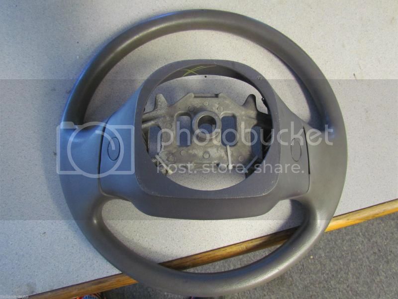

Here is a 99-07 SD Wheel:

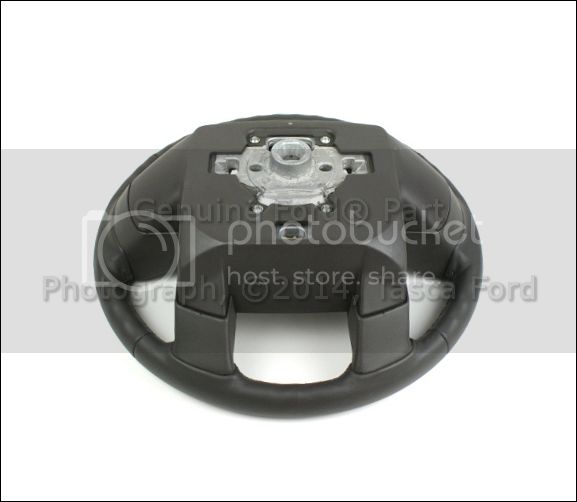

Here is a 08+ Wheel:
It appears that in the 99-07 steering wheels the clock spring recedes into the steering wheel to produce a flush fit.
Whereas the the 08+ steering wheels have a clock spring that recede into steering column itself to produce a flush fit.

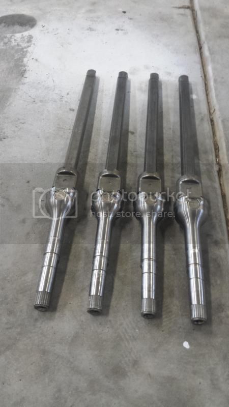

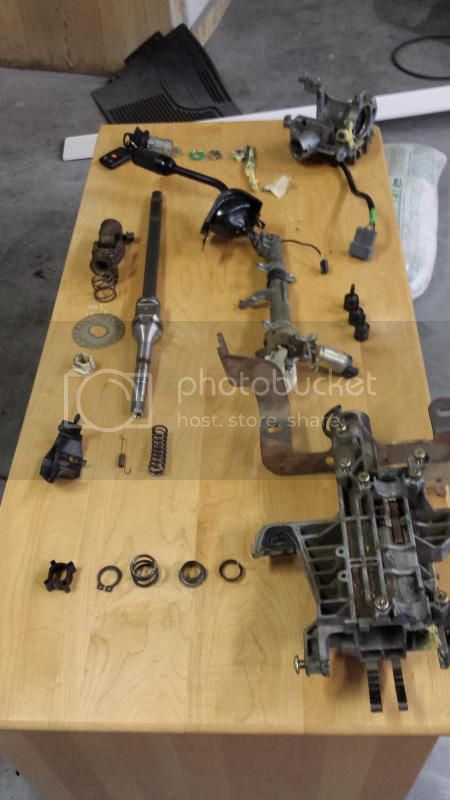

I've got a small update for everyone.
Had the time to tear down my steering column, get measurements, and a feel for the modification.
Also got some extra steering shafts, you know, incase I make a mistake...
