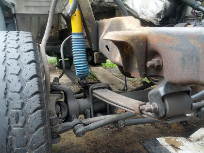

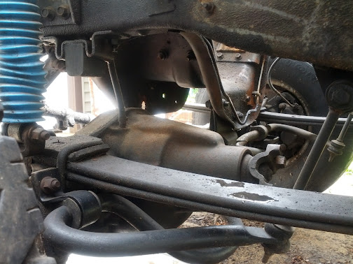

There already is not much room between the Dana 60 and the frame/crossmember on a stock height truck. That is why they sit so high on stock suspension. That is also why you will not find lowering kits for an OBS 4x4. The f250 independant axle is much more capable of lower ride heights than the solid front.
I agree. If its strictly a pulling truck, you could get away with it. You have about 3-4" on the stock 350 suspension before you hit the bump stops. You could modify them, but then you run into the crossmember/oil pan issue.

Here are some pictures. The bump stop is 4 1/2" on the left side and 4 5/8" on the right side, above the axle.
