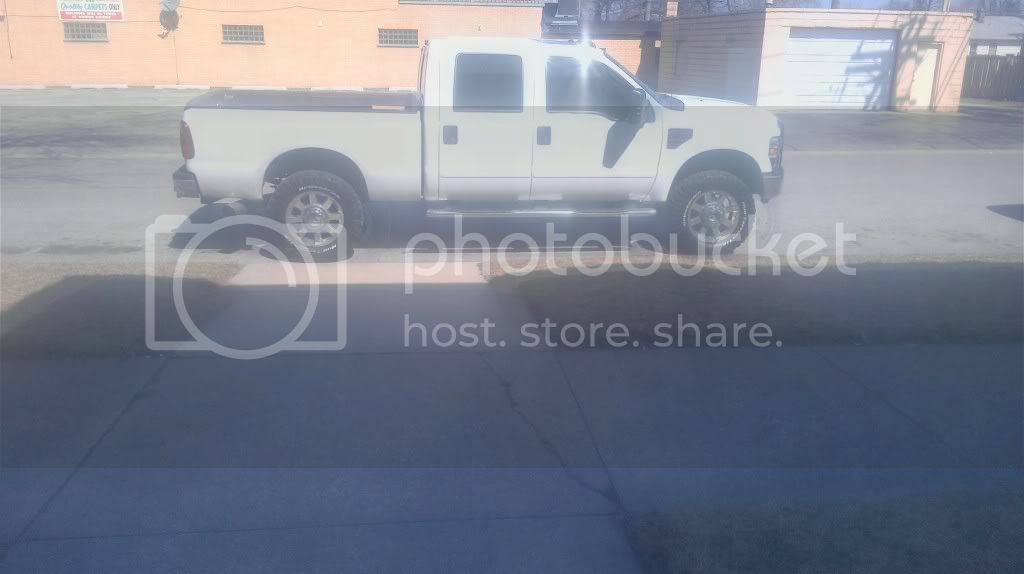

Here is a crappy picture of my truck...

Thanks for the compliments guys. It's time for new tires, and I don't feel like spending $500x4, and I want a different look for a while.
