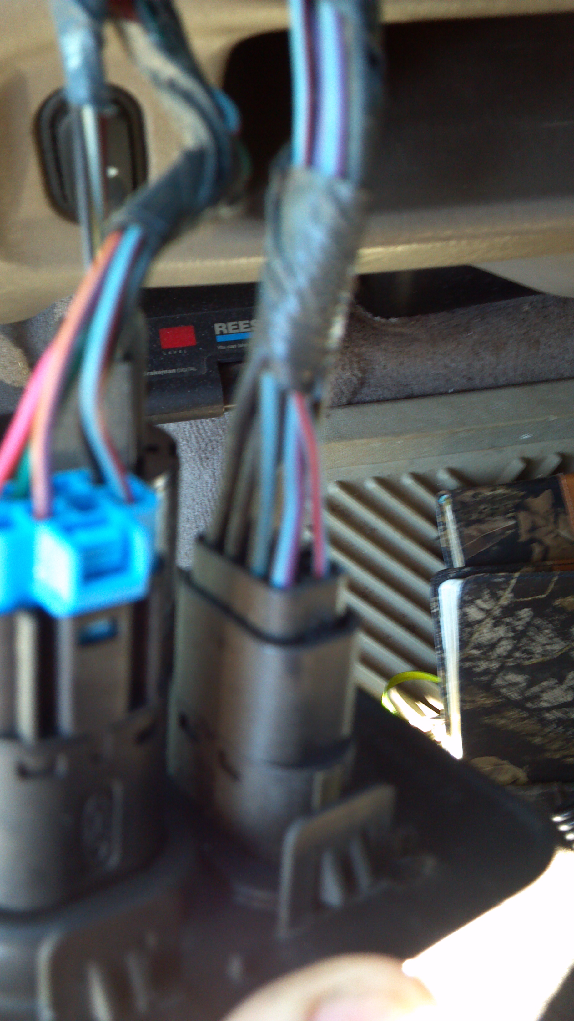

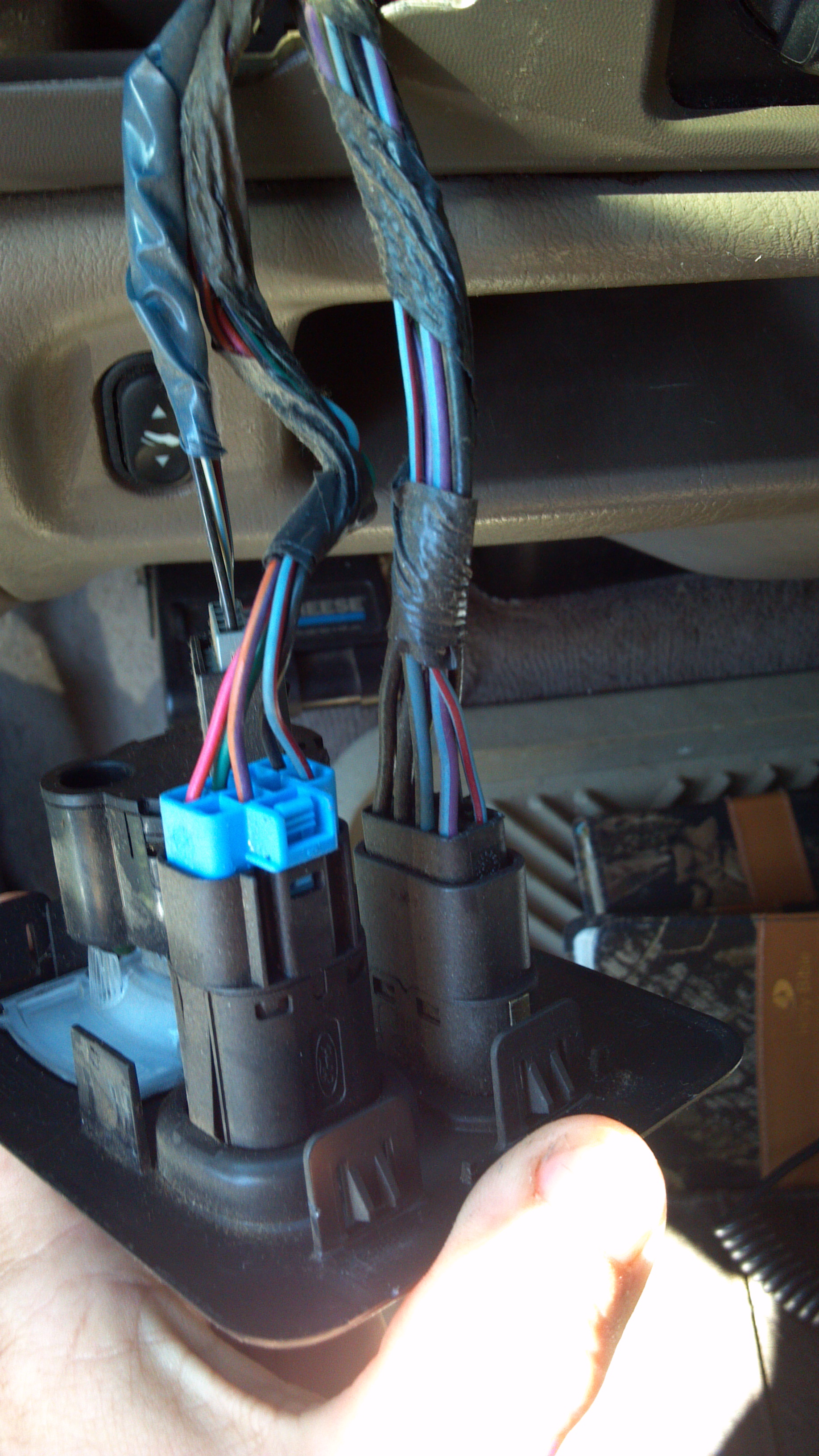

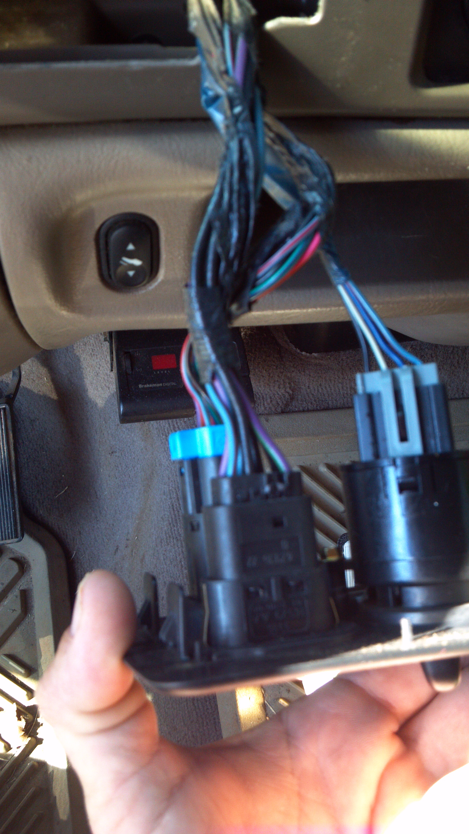

Ok the swith has 7 wires. A purple with blue stripe, dark blue with a black stripe, light blue with red stripe, purple with green stripe and three black wires. The wires are in a seprate loom that goes to the firewall where they then go into a larger loom with a bunch of other wires. Probably 30 or so. Maybe this helps if not i wil try and trace the wires further for you.

A picture would probably help tremendously here... great idea guys. I've always wanted to have a power slider...
