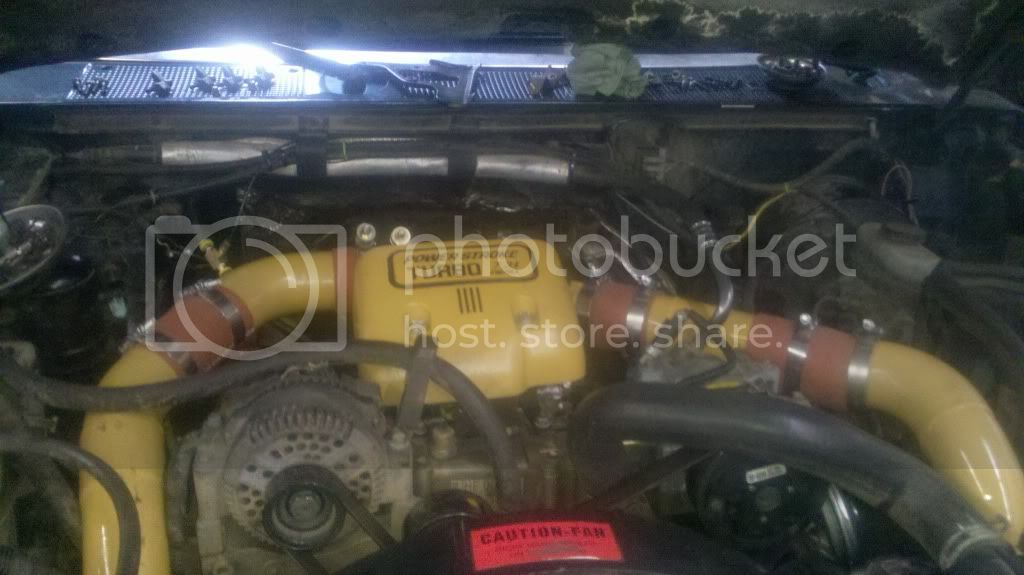

Ok so I'm build my 97 scsb I have started the project but figured I woould at least show you all what I have done so far and what is coming.

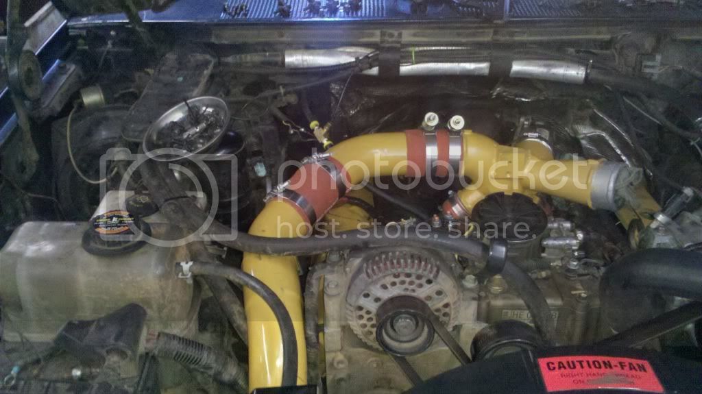

Afe stage 2 intake.

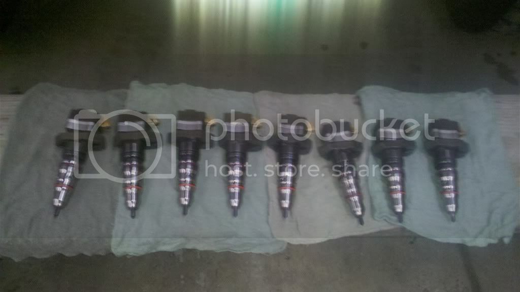

Pulled the injectors and shipped the,

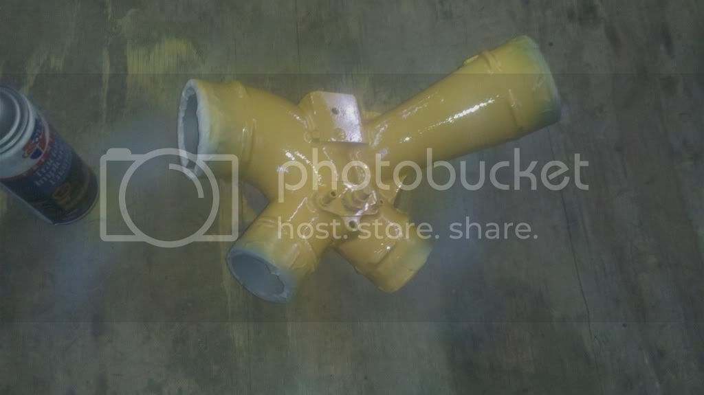

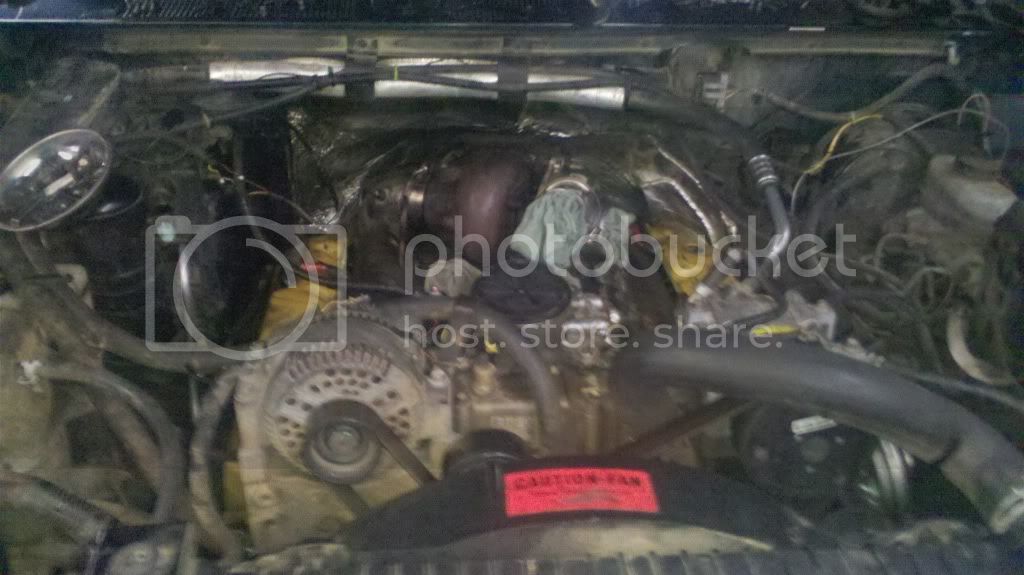

Painted the vavle covers cleaned up some things
Then I took the 1.0 housing off... for sale name a price

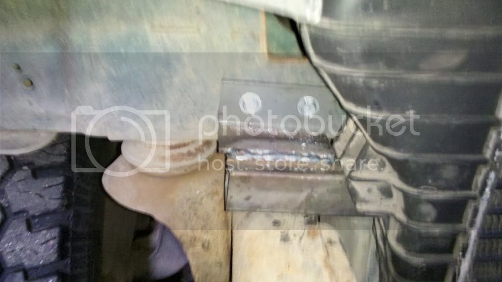

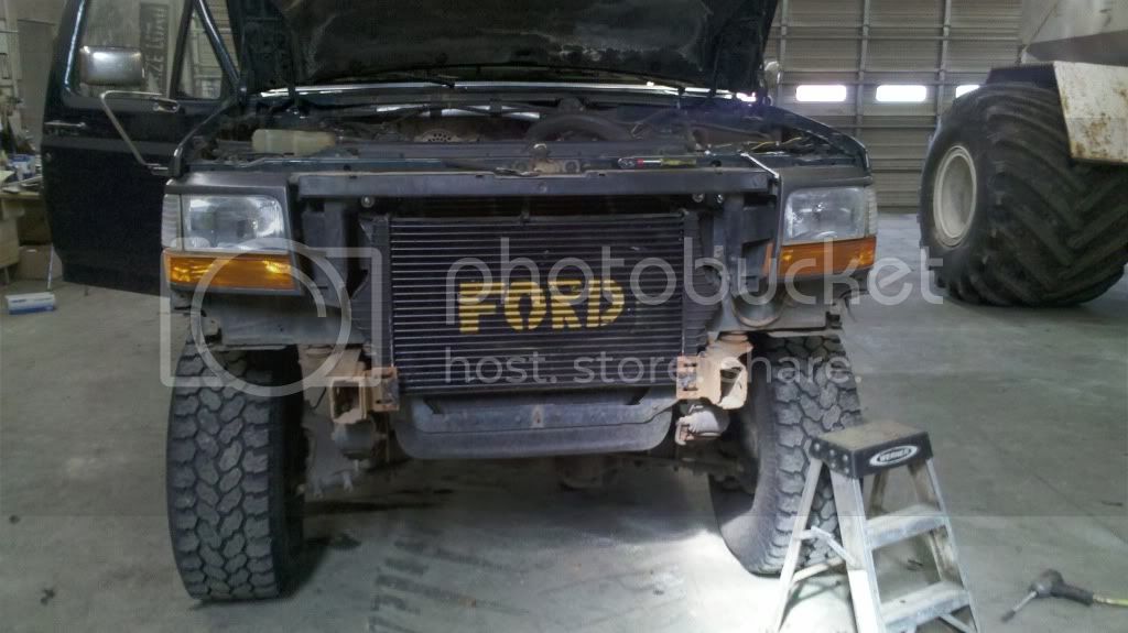

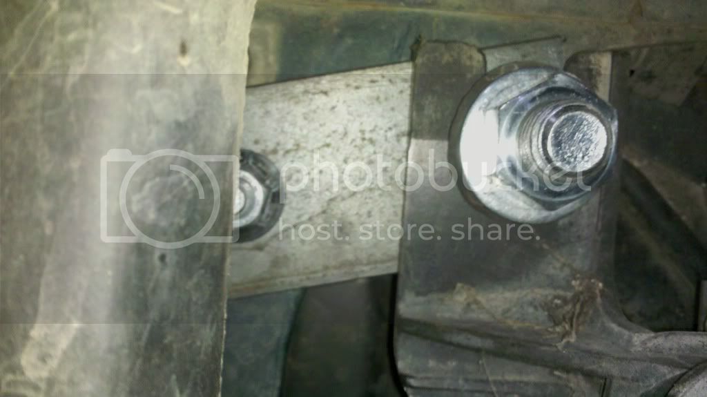

Fabing the sd ic in place
I forgot to take pics of the right side

I should add that I change the vavle cover gaskets along with the injector wiring harnessesthis is by far sthe best build I have ever done

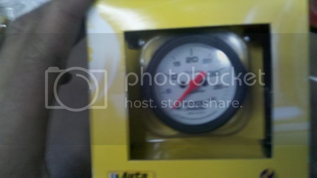

While iwas at it I added a 3 pod pillar and an hpop guage

Looks like a good start, but 2 things I'd change. I would have drilled & tapped the spyder for your boost fitting & taken it out of the map line. The other thing I would have done would be to finish up the intercooler pipes so you don't have as many boots. Not saying it won't work but it's more places that it can leak/blow a boot off from. Other then that I think your on the right track.

I agree cat I'm trying to get my hands on a bender so I can build some better ic tubes its works great now but I can see its going to cuase problems I have since moved the map into the spyder thanks for the tips though if you have any others just let me know.

Awesome build man. Love the color scheme. I agree with cat about the ic pipes. Good for now but some solid pipes will be awesome.
Only one thing though I agree that it is better to have the boost tapped in the spyder BUT depending on the gauge your using and the boost line your using, having it in the map line works great.

Well I taped the boost into the spyder.... as for the ic tubes I'm just waiting it out and doing a banks kit as it is now pulling a 28ft camper my egts get really hot and I have to back out of it lol
