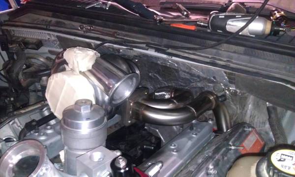

i had it shipped to tadd, to put on my truck, but we ended up putting it on the shop truck, due to my decision to do the trips. i purchased the kit because "I" wanted to know how it performs, driveability, smoke, power, etc.. compared to the twin trucks. craig has said, its pretty damn driuveable once you learn how it acts, and has some spots in the rpm that arent very friendly for street driving, but very manageable once you find the learning curve. this first post is in regards to fit and finish. tadd said the manifolds are very nice, good fit, and appear to have very good flow. the mount is nice for a hand fabbed piece, the turbo fits great. tadd modified the oil feed a bit, and a small change to the hot pipe, but all in all its a great kit. it should be fired and running this weekend in hopes to dyno on hallers dyno, it will be run with 150's iirc, and dual fuelers with elite lpfp. im interested to see how it acts up there. im sure if its managable at sea level it should light there. here's a couple pics, thanks craig for the good stuff and good service, sorry it took so long to get going.
p.s. the upipes look sick!
