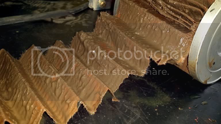

I have had a coolant filter on for a few thousand miles now and it really cleaned up the system.
This was my first filter, only ran it 1500 miles

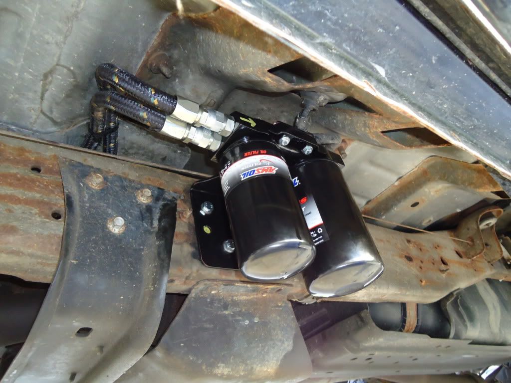

and I chose the Amsoil dual by-pass for oil side

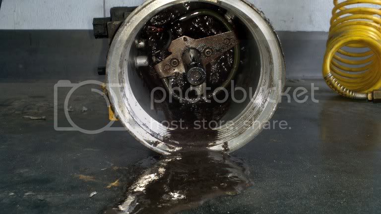

when changing the fuel filter, maybe even take the entire bowl out to clean it. The seal kits are cheap and its much easier, especially if its dirty like this one...
