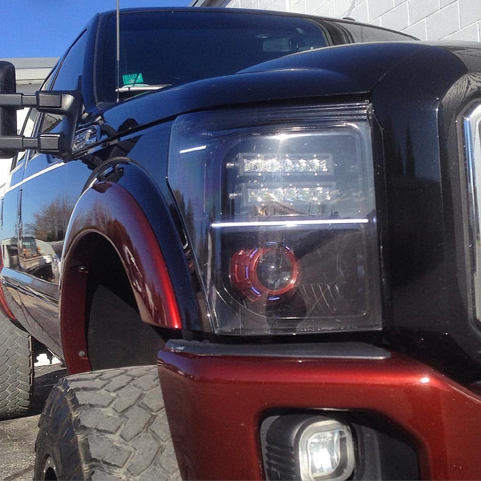

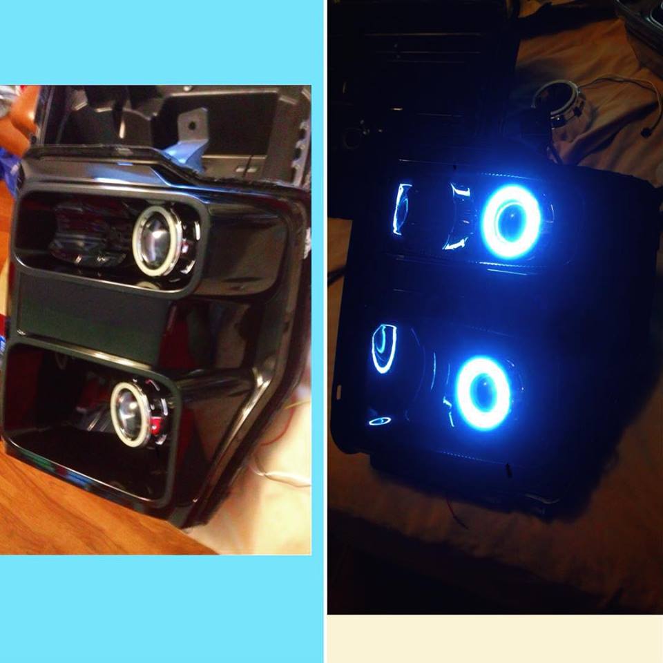

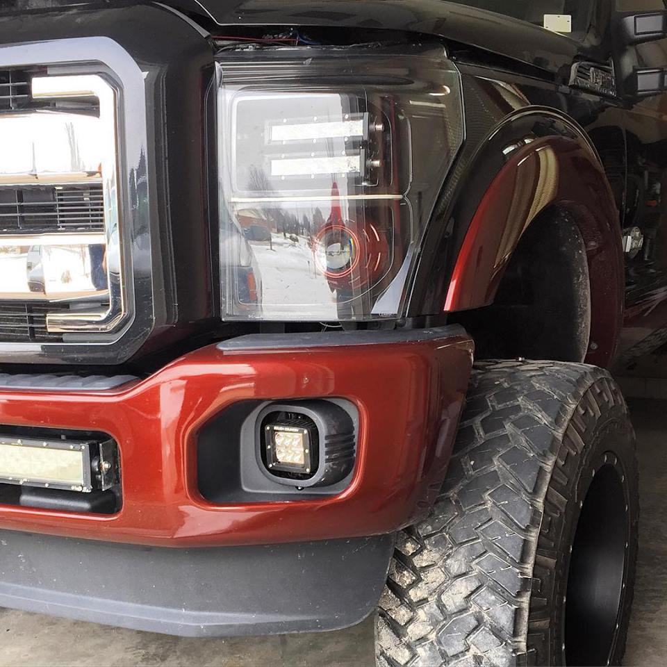

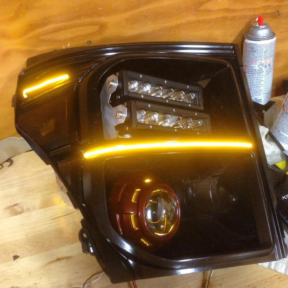

alright been asked to show a few pic of my lights i made, i used morimoto d2s projectors with apollo 3.0 shrouds painted to match bottom trim color on the truck. i have morimoto switchback led halos behind the projectors. up top is two 6" led single row led bars. also have morimoto switchback strips between top and bottom bowl and ontop of side reflector. housing is painted UH tuxedo black to match truck. heres a few pics, always have such a glare from the sun in all my pics! last pic is halfway during the build to show the yellow leds which are used for signals.

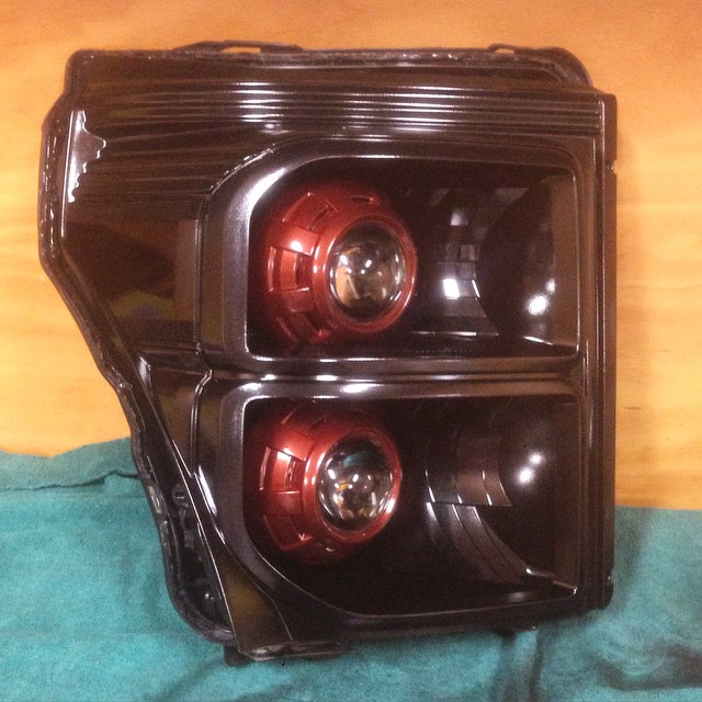

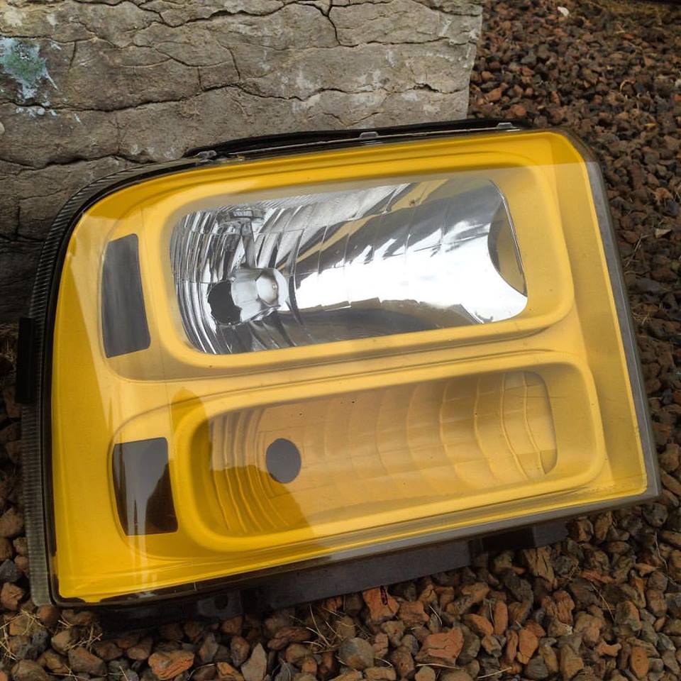

if your doing this on 6.0 style lights they come apart real easy since ford used different sealant back then... alot easier to take apart then the 6.7 lights! heres a set of light i did for an Amarillo edition truck

That looks food man. I am doing it on a set of eagle eyes 6.0 lights. Just use ckear silicone when going back together?
adrian94
Jan 18, 2016
13
depends how much factory sealant is still there when you open them, sometimes it stays intact pretty good, other times gotta chip and tear the seal... when i gota put new sealant i use butyl rubber, available at most auto stores, also called butyl windscreen sealant... heats up in the oven, and seals the lights up nicely.

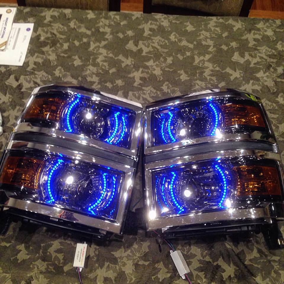

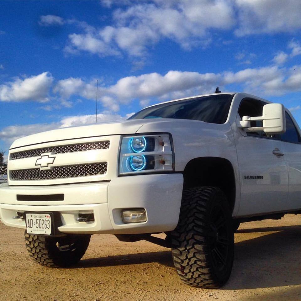

heres a few more builds ive done recently...

Where did you get those brackets for the single row leds on your headlights?
Those where some quick ones i made just to do the mock-up and get the holes in the right position.. Made some new ones om the final build.. Just bent out of aluminum
