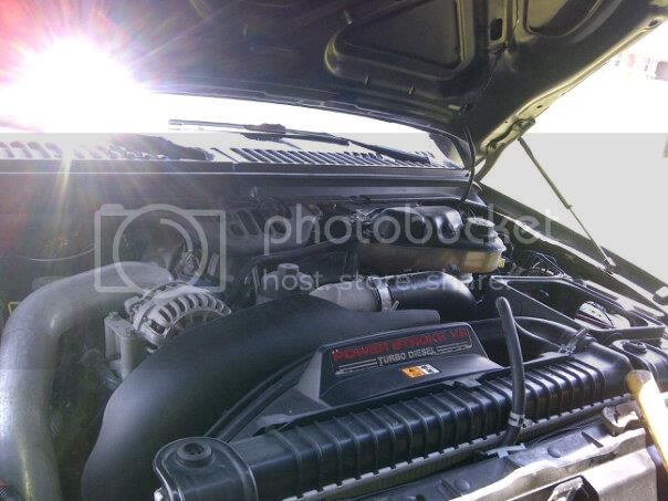

a buddy of mine picked up the whole banks IC setup and an afe magnum force intake for 450..gonna put it in here in a few mins..im headed over there right now..ill post pics of the progress. Any of you who have done this before, is there anything special we need to do or need during this procedure?..ohy yea..its an 06 f-350

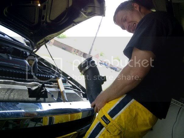

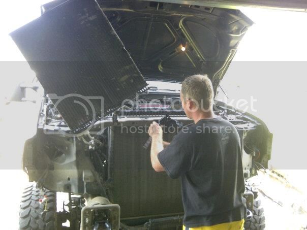

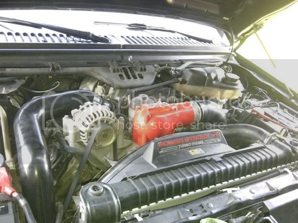

10 4 we got er did...pulled the 1 piece backing off the front (the 1 piece that goes behind the headlights and wraps around the front) pulled the front bumper, flipped the a/c up and removed the tranny cooleer and pulled out the front

Glad you got it, but why'd you go thru all that instead of just pulling it out from the top?
Sep 9, 2011
880
Oregon
I was thinking the same thing. Couple more bolts and the motor would be ready to come out.
But hey I guess everyone had there own way of doing things. Glad you guys got it done.
Nic
Mar 18, 2012
1,766
Santa Fe, Texas
well, was our first time doing it..havent really worked on the 6.0 much but it went fairly quick.
