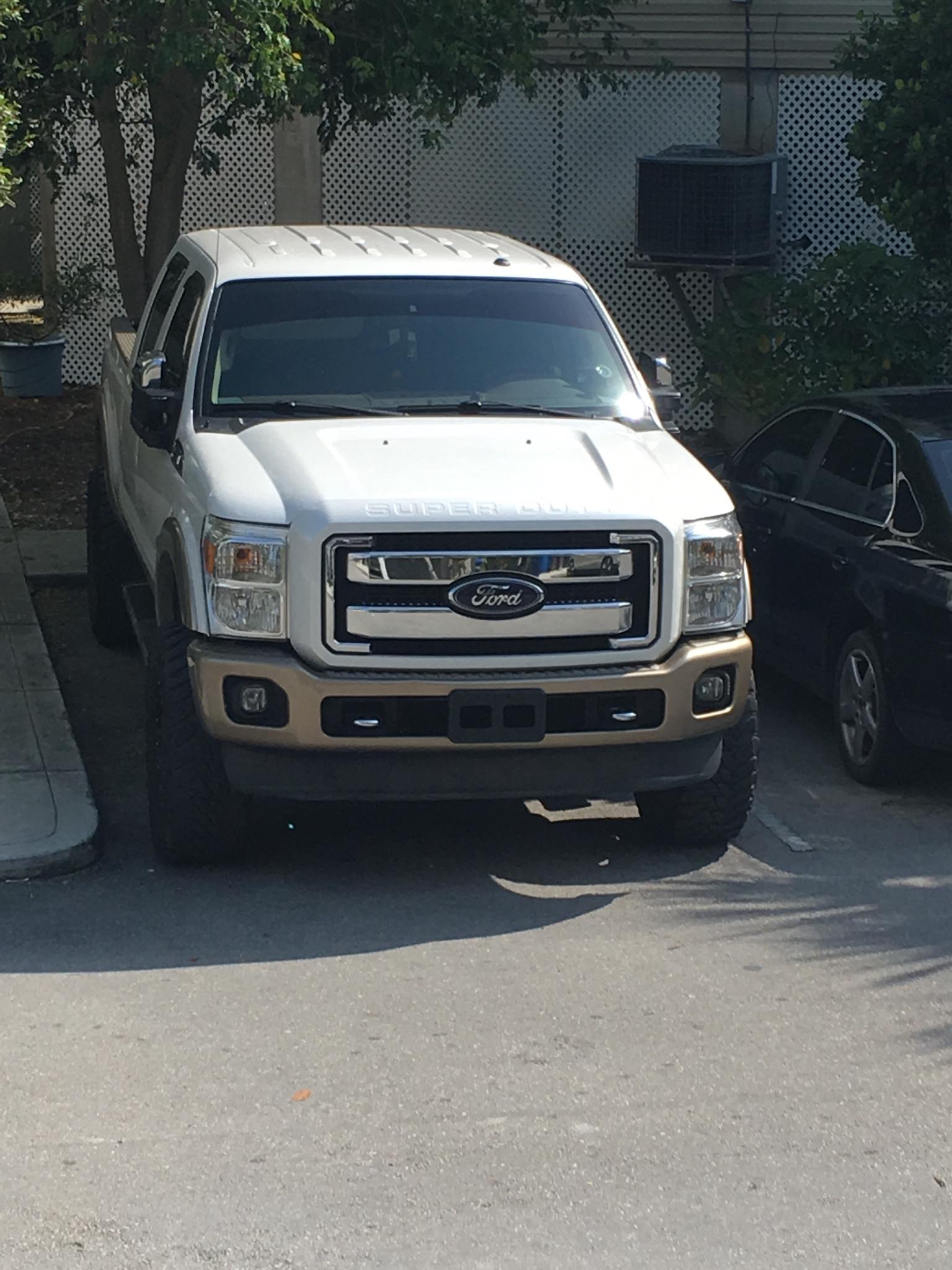

3" rough country lift. 0 rub.
20 x10 XD hoss
35x12.50
