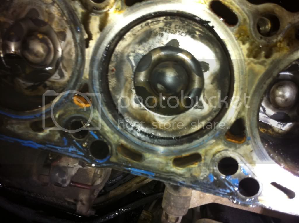

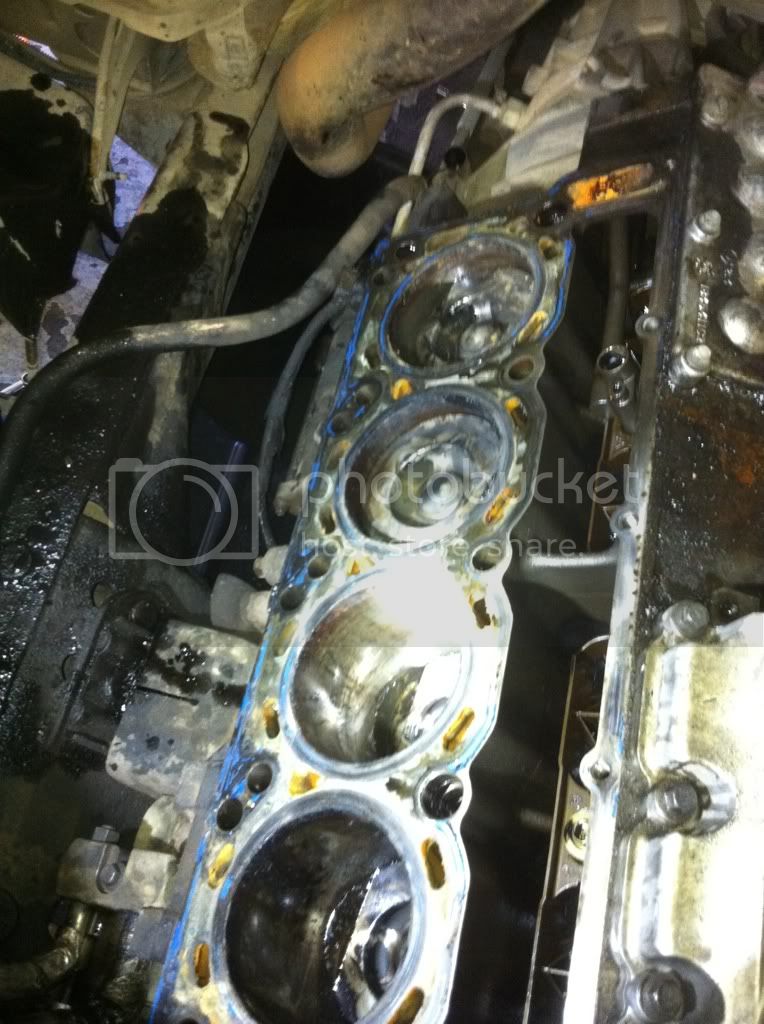

Ok guys another guy is working on this turd. It's got over 100k it's a electric boom truck it came in on the hook. Hydro locked. Pulled glow plugs ran compression Test foun left bank 100psi found right bank 300 psi. Well performed tear down found inner dp rusted. Pulled heades found cyls rusted and this crazy injector pattern --- has anybody seen this?
It's a first for me.
We found some scoring on cyl 8 but no real reason to be 400 psi down on left bank going to test valve seats 2maro
