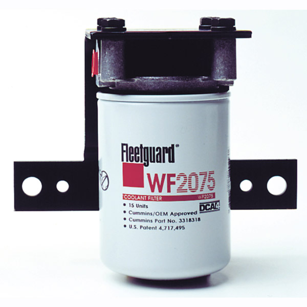

The post filter parts I am considering using here are the pictures and part numbers: Fleetguard 142784S Fuel Filter Head by Cummins Filtration (or mount head Fleetguard #3930618S); plus the mount bracket, Cummins Filtration.com part number: 3312054S; and a filter like the Fleetguard FF105.
