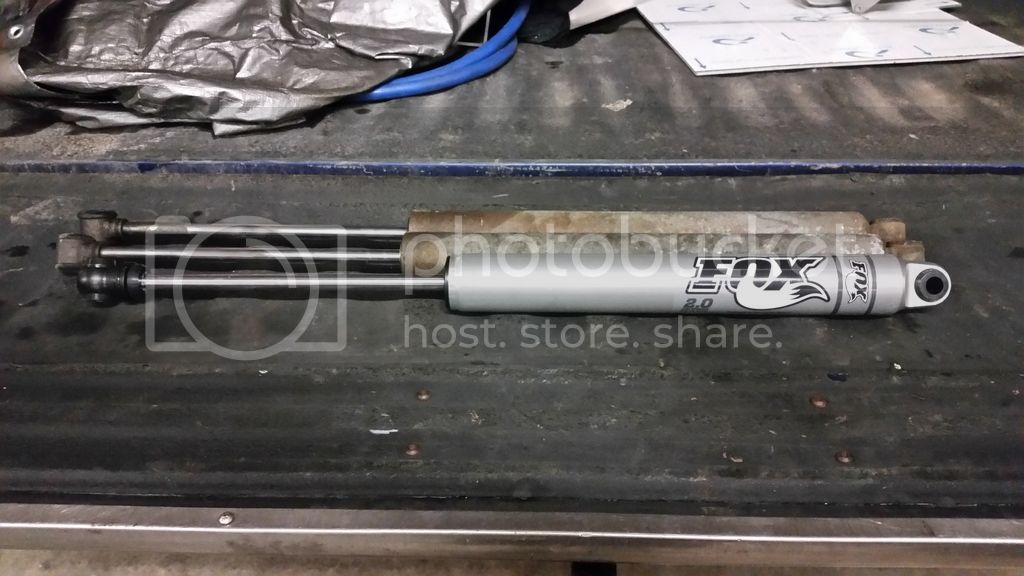

I just installed new fox 2.0 in the rear and it has seemed to smooth the rear out. I removed 5100s which looked terrible. Still waiting on my 2.0 remote resis for the front

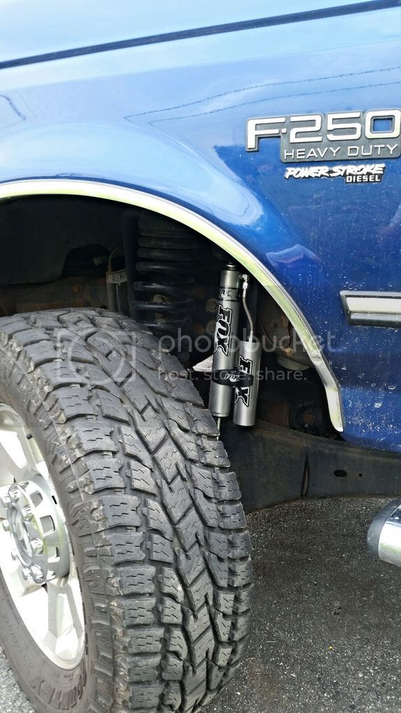

Got my remote resis on the front! I may buy the bracket to mount the resis on the frame to the right of the shock. It is VERY close to rubbing on full lock.
To answer the question before, the 2.0 was 150? Each and the 2.0 with resis were 225 each. The ride is awesone! And was valve specifically for MY truck based on front and rear axle weights which came out to 4800/2400lbs
