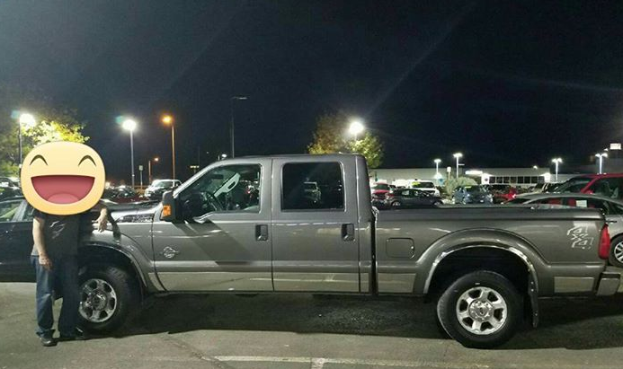

Hello All,
I am new to the diesel world with buying my dream truck. I got a 2013 F250, it has about 63k miles. Bone stock. (Just added running boards).
I have been driving for a few months but love the truck. However, I need some advice on a couple points.
1) While she is powerful, I would like to a pep in her step. I live in Denver and she is under warranty, so I can't necessarily ******.
2) I get she is a huge a** truck meant for hauling. However, is there anything I could do to make riding those Sh*** roads a bit easier? Hitting those bumps softer?
Look forward to hearing your advice!
