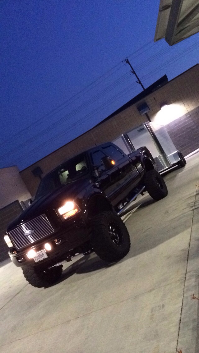

Nice pull man. Here's my harley. That's a sick set up ImageUploadedByTapatalk1408128518.638883.jpg
