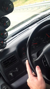

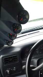

Both vids are in tune 4 of 6, Gearhead tuning. Drive, boost, EGT, fuel pressure, top to bottom.
Vid 1 is a 3, 4, 5 gear run. I did my best to make it a smoke free run (with Matt's tunes that's pretty easy) so that puts the accel pedal about 80-90%. It spools a bit quicker in hotter/smokier tunes, but I wanted to post a vid (like I'm hoping others will to) that would represent what tune most of us would drive our truck around in for daily use/towing.
Vid 2 is OD (6th gear) run from 65 mph on flat ground. I kick off the cruise, hit record. EGT started at 600-625 at the beginning, and I put the pedal to 90%.
I'll try to get a towing video posted soon.
In summary, for the S467 FMW with the 1.10 housing, enough HPOP, and 200% nozzles, and a ZF6...it looks like this turbo "lights" or becomes responsive around 800-900 EGT, and 1800-1900 rpm.
At 65 mph with my tires, engine rpm is right at 1800 in 6th/OD, so for towing it works great (even using cruise), 'cause as soon as there's a grade, boost is right there. Higher altitudes, or really heavy towing at slower speeds, I could see using a smaller turbo.
