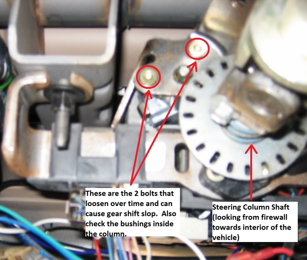

Next time if it happens, see if it will start in Neutral.
Is your shifter sloppy?
There are 2 torx screws that are common to loosen up and cause issue.
