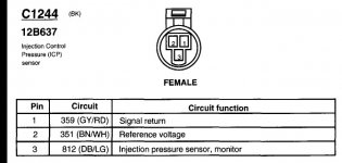

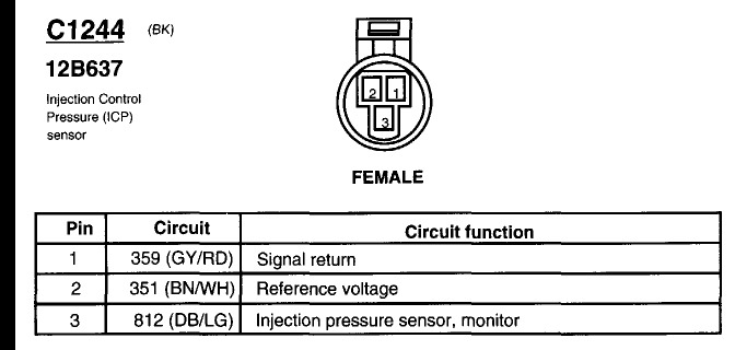

did it throw any codes? Have u checked to see what the icp is while cranking? Also check stupid stuff like fuses, oil level, fuel in the fuel bowl etc. Sometimes its easy to skip over the small stuff
01 blue 7.3
Oct 17, 2011
305
illinois
I don't have a way to check for codes. The check engine light hasn't come on. Which doesn't mean any thing. And how do you check the icp?

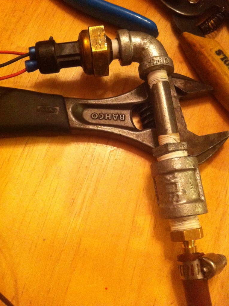

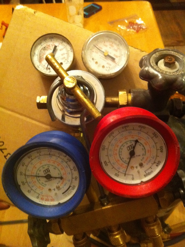

They can be checked manually. Not the most fun though. (third pic compliments of PS)
