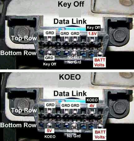

I'm looking for the pin out for the OBD connector. Scanner won't connect and I'd like to check for a possible bad ground.

Here you go man
