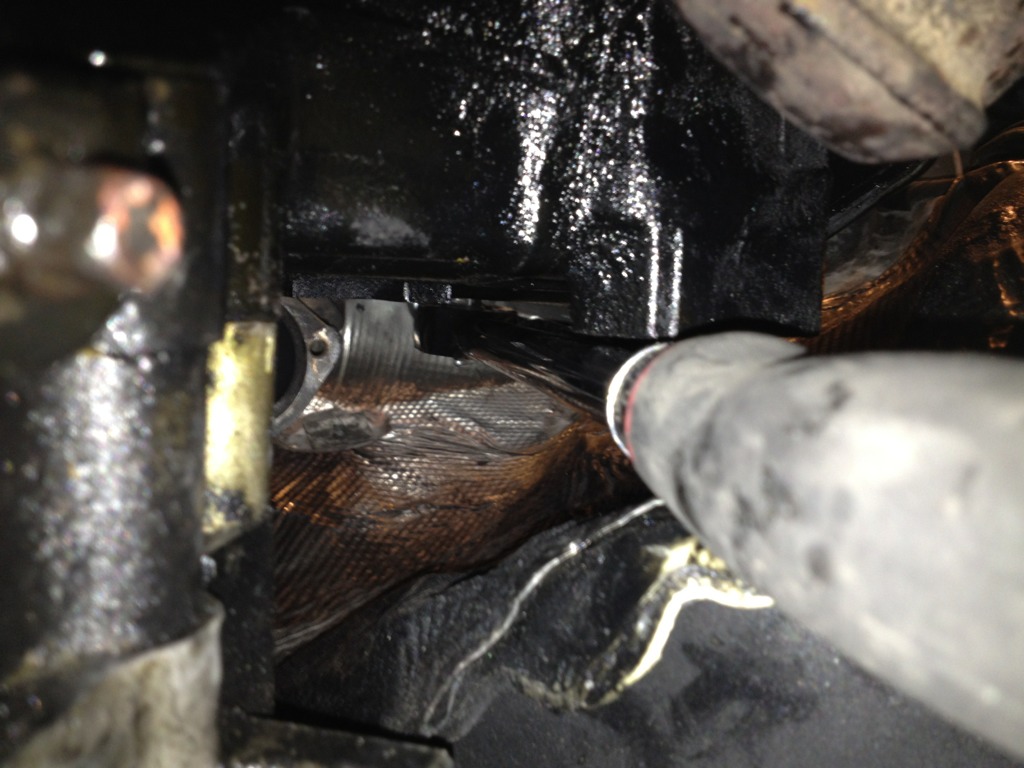

Yup pull the alt and bracket should look like this. Mine was leaking at the back of the driverside head and I am needing to do the others for insurance. ImageUploadedByTapatalk1344381123.937952.jpg
1/2" drive and some big balls to break it free. I used pry bar and front driveshaft from under but where yours is should be easy

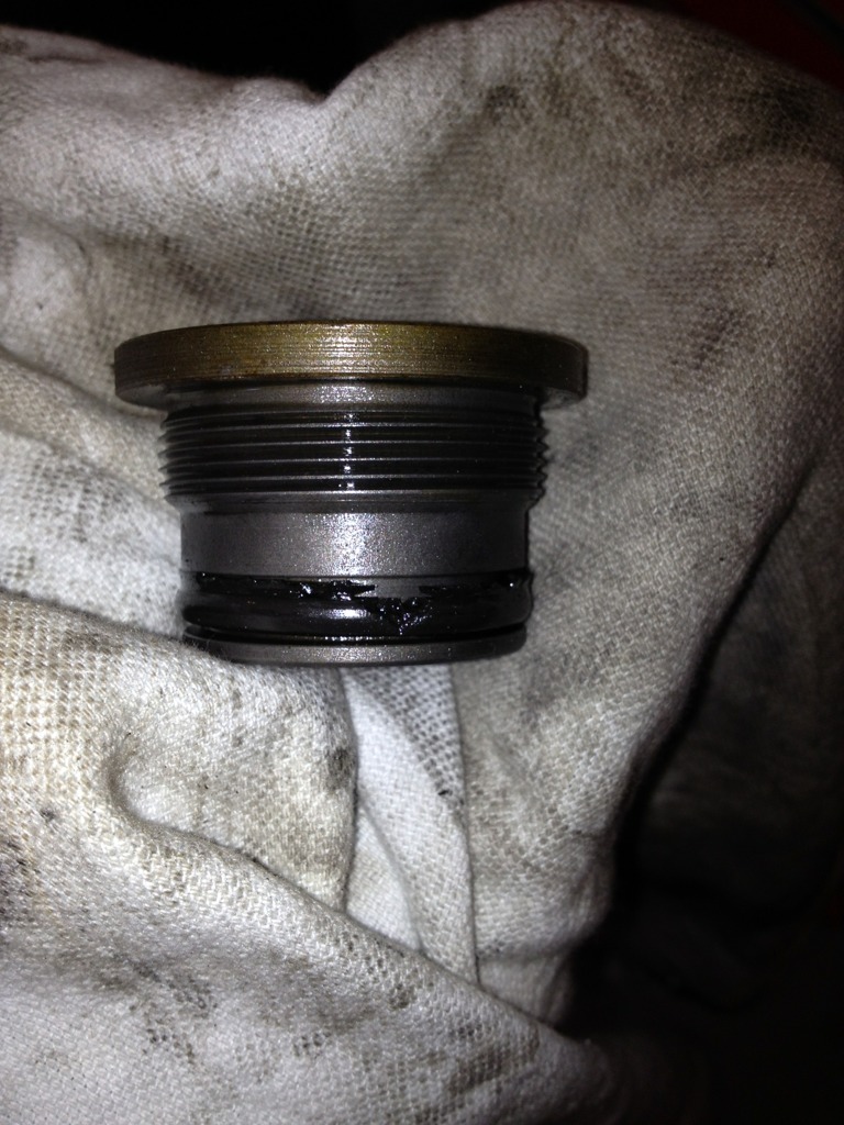

Thanks for the info. It looks like it has an o ring on it. Do you just replace the o ring or put a new plug in it and where can you get it.

Ford and I bought a new plug and seal as the new design is better. I think the seal is 5 and 7 for plug. And now I have a extra plug just need to get seals.
Mine let go after I changed oil and it leaked about 1 qt every 1000. I was shocked it didn't leak more being that it holds back some serious psi.
Be aware the plug has about a qt of oil behind it. I had my drain pans ready and did the switch.

NEW PLUG. Plug and oring from Ford. Easy fix. Out of the 4 there are every 7.3 has or will have one leak. lol
