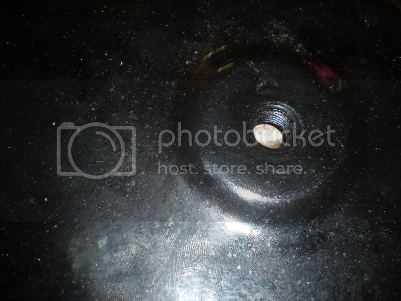

Was about to put my oil pan on when I noticed how close the pick up tube is to the bottom of the pan. You can see it through the oil drain hole. The tube is bolted in place and there is no adjustment .
I had to do a bit of massaging to my oil pan to gain clearance, but since I used a girdle it dropped the tube a good .250 down into the pan.
