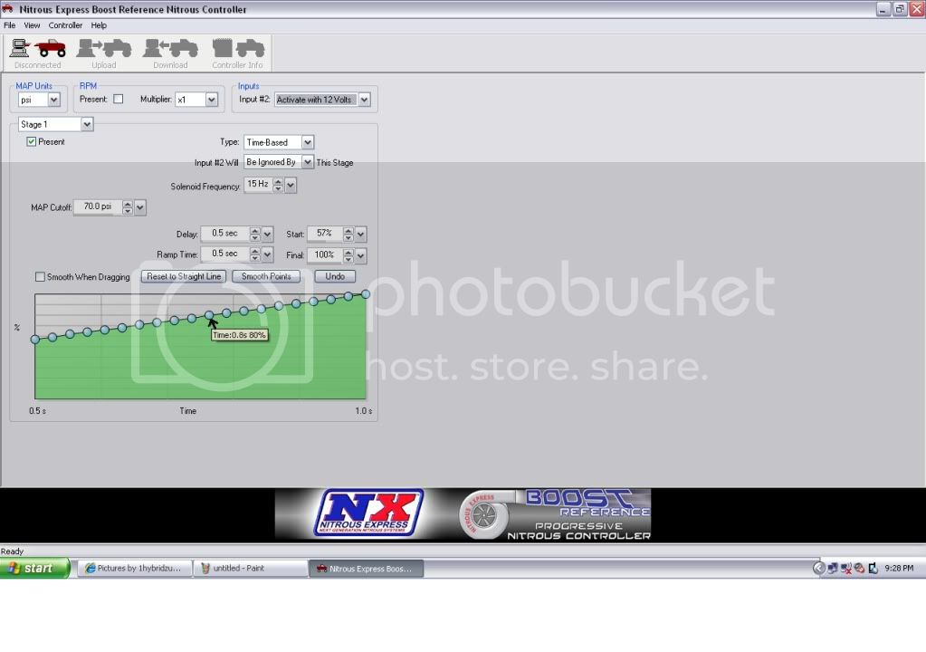

ahhhh the beauty of the progressive controller......
1st Stage

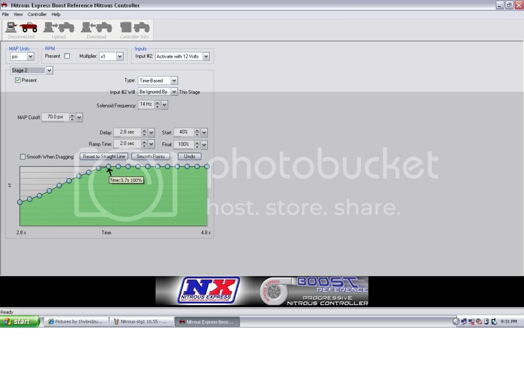

2nd Stage
If i was you, i would do "time based" for the drag strip and "boost based" on the dyno, but thats just me......The TPS sensor is pretty much used as a WOT switch for the controller, just lets it know when its safe to spray.

how long ago did i tell you to get that?? its so user friendly its sick. have fun!!
