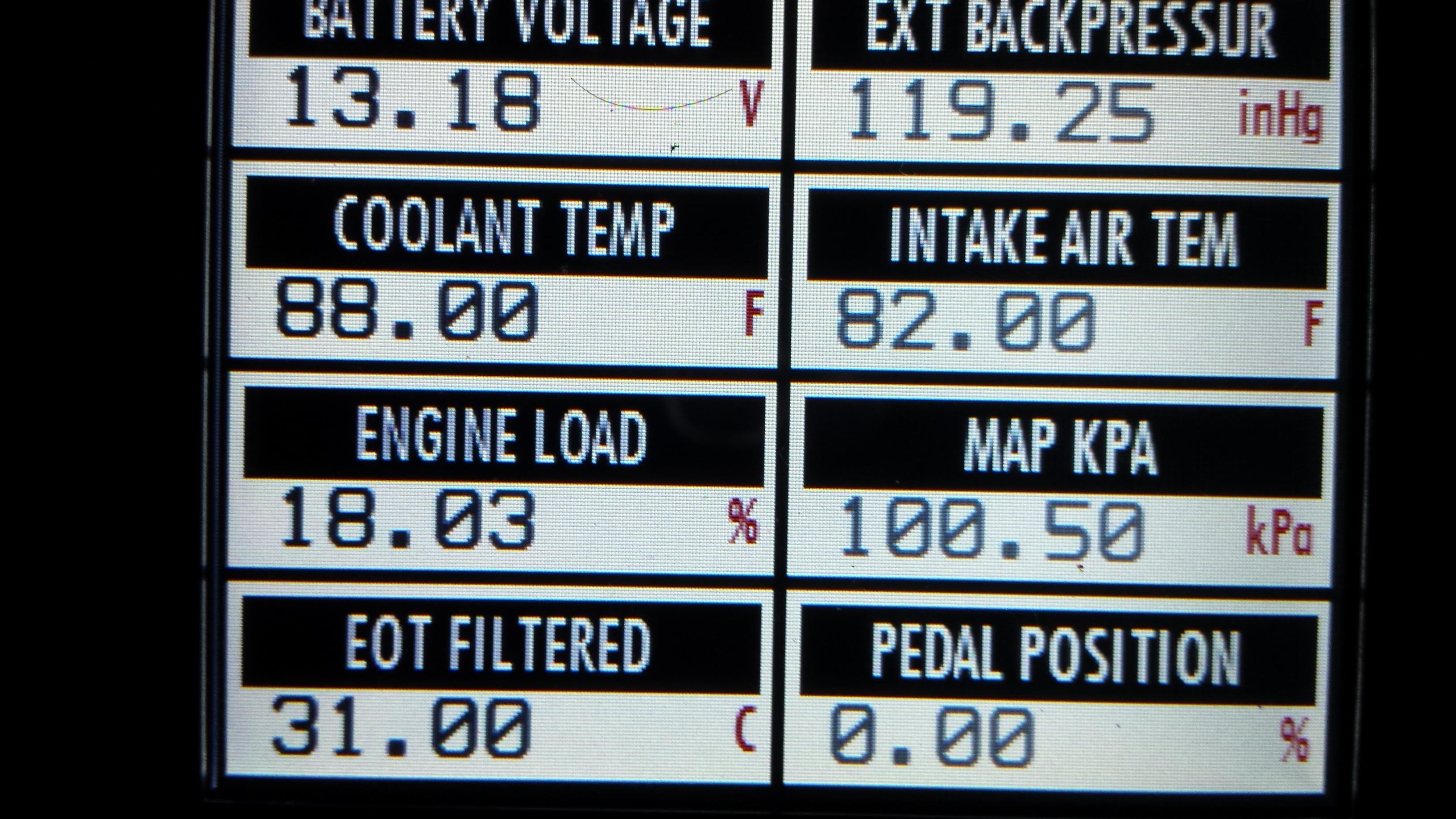

I got an orange warning light and a "reduced power" message on the dash. I press on the gas and the engine revs and sounds loud but it feels like no power is going to the wheels. I thought it was the egr and *** so I went ahead and ******d those. I bought an sct x4 and I'm getting my custom tune with the egr and *** from dpe diesel performance engineuities. I'm afraid this won't solve the problem though. I'm thinking of getting a coolant filter and doing a coolant flush. Also I'm thinking of buying an auto engineuity obd2 scanner from riff raff diesel because I'm just throwing parts at this problem and I'm very much in the dark. It's $349 but I figure I'll probably pay that and more with just one visit to ford. I know that's a lot of info but the short version of what I'm asking is. Anybody have this wrench light and know of a definite fix? Thanks guys. Oh and I included a pic of the sct scanner readout at idle.

you need to start off by checking the codes, if its in reduced engine power It should tell you a code.

:whs: wrench lght can yhrow for many things. From thermostats to hi pressure and low pressure fuel issues. Pull codes and get back to us.

I tried getting codes from my sct scanner and I received some nonsense general code errors that are not ford. I'm going to get my hands on an obd2 scanner and give it a shot tommorow. If not I'll have to shell out for the auto engineuities scanner with the ford package. I'll also do some reserach today and after work I'll locate and check the hoses today buckii2, at least that's something I can do that won't cost an arm and a leg. I appreciate the tip. Thanks for the feedback everyone. I'll get those codes up here as soon as tommorow.
