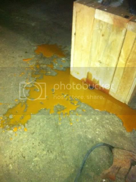

I took my traction bars off for the first time since installing them a little less than a year ago and had them spill alot of water out. I've only driven the truck about 5k miles with them on. Never saw snow or salt. And honestly wasn't even washed that much. Nor does it see an ounce of off road water crossings. All orings are in place on the coupler. I'm not too happy about it. Anyone else have this issue?
PS bar...this only half of what came out unexpectedly.
Both bars had about the same amount.

I've always wondered about this but have never seen it. I hope the make it right for ya, it couldn't have done any good to the inside.

Rotting from the inside out. All it takes ie some temperature change and condensation builds inside they almost need a small drain hole in the bottom of the bars to let any water escape

You think condensation would amount to that much water? I poured out alot of water. One side was actually near being completely full.

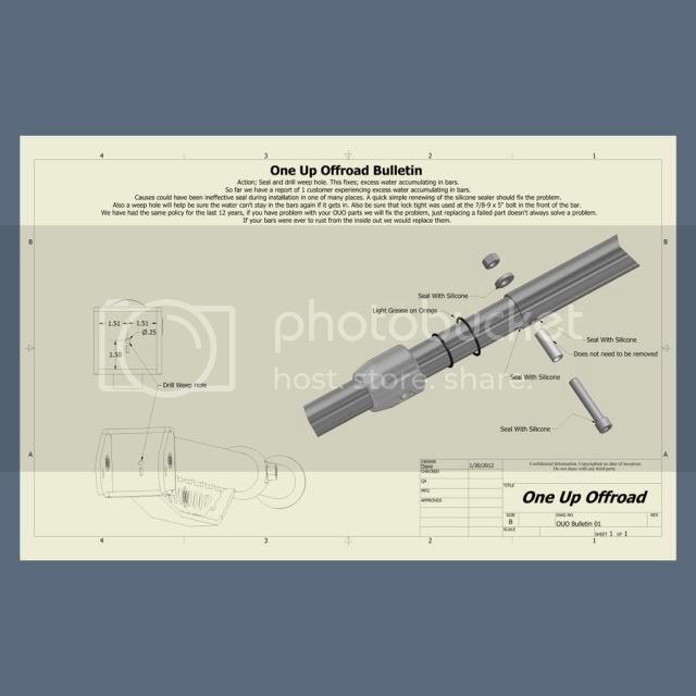

I should've brought this up with Dave first before here and I do feel bad about that. He will stand behind his product. I'm still a 100% satisfied customer and will still speak highly regarding OUO's products. Never felt otherwise even with the water issue.
This is what Dave drew up to hopefully remedy the situation.
