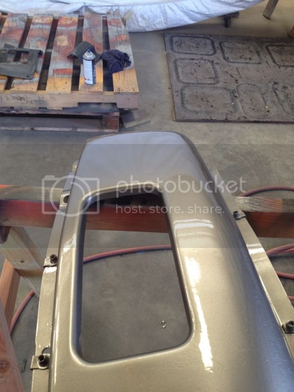

So I painted my '05 bumper and Harley Davidson grill this weekend. The paint laid down nice and smooth but the clear came out a little orange pealy. For whatever reason I do ok with paint but I suck at shooting clear. LOL
Can I buff or wet-sand the clear to make it smoother? Pretty sure I've heard of that but not sure what I need or what the process is. Thanx!
Here's how it looked BEFORE the clear. LOL

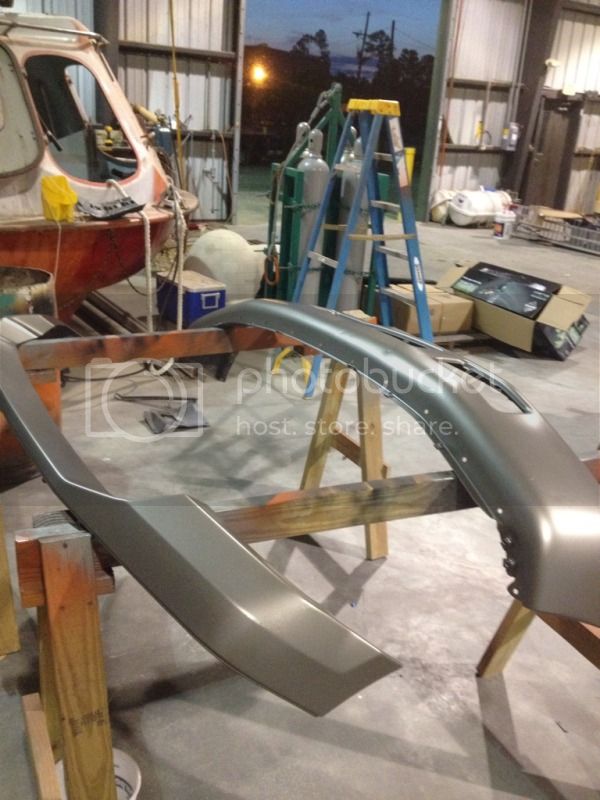

Keep in mind this is far from a show truck and the whole thing is gonna get wrapped eventually which is why I didn't really bother with any body work:

clearly i'm not a paint guy at all lol. but I really can't see anything wrong in those pics could someone who knows about paint explain whats wrong?
Dzchey21
11,784
wyoming
It really don't look that bad Danny.
If any thing sand and recluse. They look awesome doing it like that.
