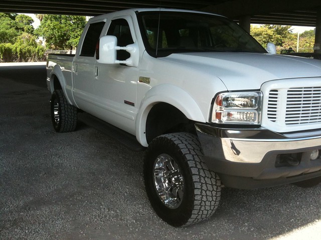

I had my factory ones painted to match my truck. Three coats of paint will make the handles smooth.
Not a good picture but you get the idea. Also painted the mirrors and chrome grill.
truck under bridge by MooringProduct, on Flickr
How did you ever get the paint far enough inside the extension arms of the mirrors?
I just got a set of the new 08+ mirrors and wanna color match them to the truck...
You did a fantastic job btw!

So if they are darker does that mean I might have used too much clear?
Pretty much. The more clear you use the more it "pops". Makes the paint looks darker and glossier on a faded truck. From the pic, they came out great.
I just used rattler can on mine.
As far as the mirrors go, you can either take your chances by painting the mirrors with them in one piece all the way extended, or completely disassemble them and paint each piece with equal coats. The problem with painting extendable mirrors is that after sliding them in and out so many times, they eventually wear the paint down where the two posts slide. I had my mirrors painted without the extended posts having paint on them. Painting them can also make them stubborn to slide if you use many coats.
