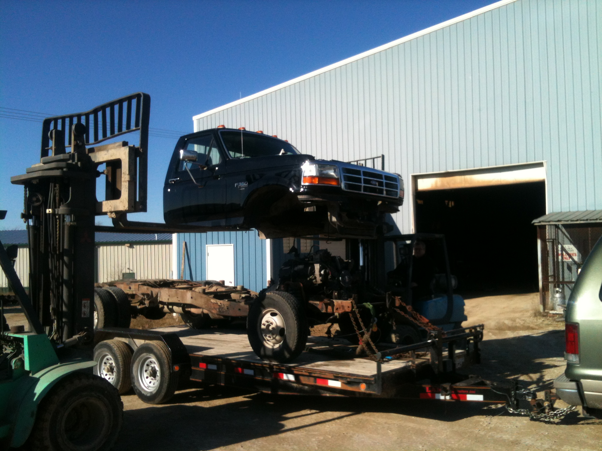

This is what you have to do:

I didn't get the forklifts over here. I put it on a trailer and took it to work to pull the cab.
You could probably use a nylon sling and preferably a spreader bar to pick it up with one forklift. You might need an extension to keep from rubbing on the mast. Alternately use cribbing to pick it up bit by bit with the forklift and alternate sides to get it up in the air.
