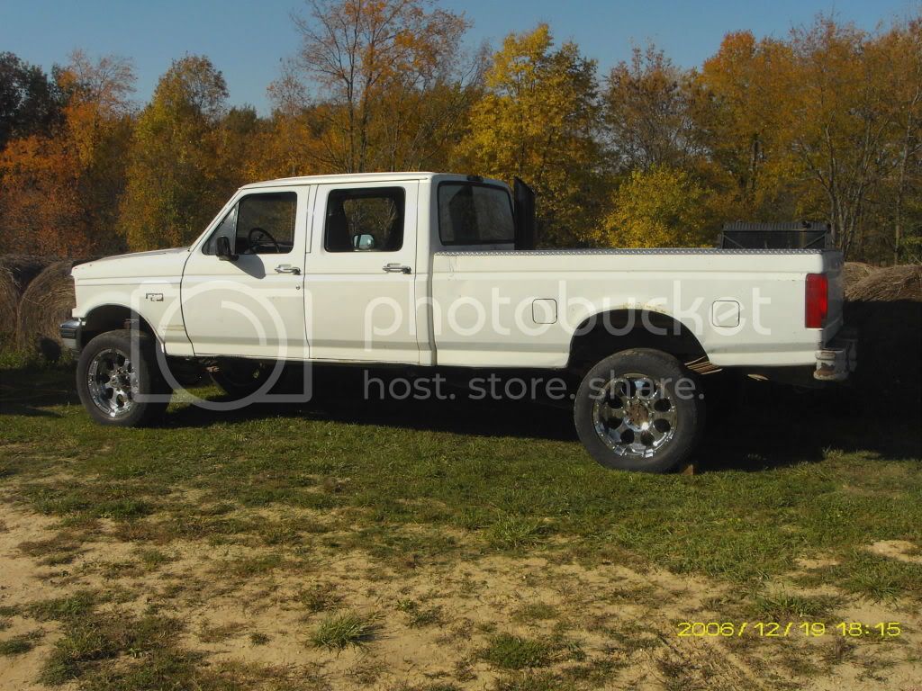

I am debating on converting my '97 F-350 into a dually... Here is the truck that I am wanting to do it to:
I love the way it looks now, but I really miss my '97 Dodge Dually... I would run a 16x10 regular wheel in the front and 16x7 dually wheels in the rear to be a little different with 285/75/16 tires. One of the main reasons that I am debating on the conversion is that I will have a Eaton Fuller FS5205A transmission in this rig behind my p-pumped 24V, so this truck will be used for pulling everything on the farm from cattle, grain, tractors, etc. This will be our my dedicated tow truck, so I know I would really like the extra stability of the dual wheels. Let me know what you guys think... BTW, has anybody done the conversion without swapping to a dually rear end? I think that I could run a small spacer on the inside of the hub between the wheel so that the tires will clear the springs. Just trying to save some money on the conversion if I decide to do so, the engine conversion is already eating up a lot of my money! LOL

You probably already know that the dually bed is totally different. Also the OBS wheels were hub centric and not lug centric, so you would need to make sure that any spacers take that into account (otherwise the wheels may end up off-center. If it's a 4x4 you will also need to worry about front/rear tire diameter difference issues when 4x4 is engaged. Just some thoughts. Cheers!

Yep, already have a line on a dually bed for the conversion if I want it... All the tires will be the same diamater, just planning on running a srw style wheel on the front rather than putting the dually spacers in there. I like the look of that better than a regular dually wheel up front.
