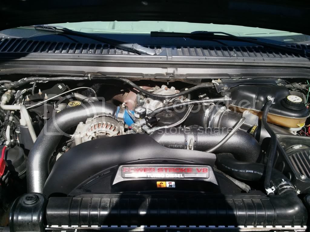

When we built my new cold side pipe, we rolled a bead on both ends so the clamps would hold better. Thinking I might still shoot some hairspray on em' for good measure.
Mwilbur516
4,700
Thats carbon-fiber hydro-coat over candy red powder-coat, topped with clear powder-coat. If you're interested in a set or having yours done PM me.
