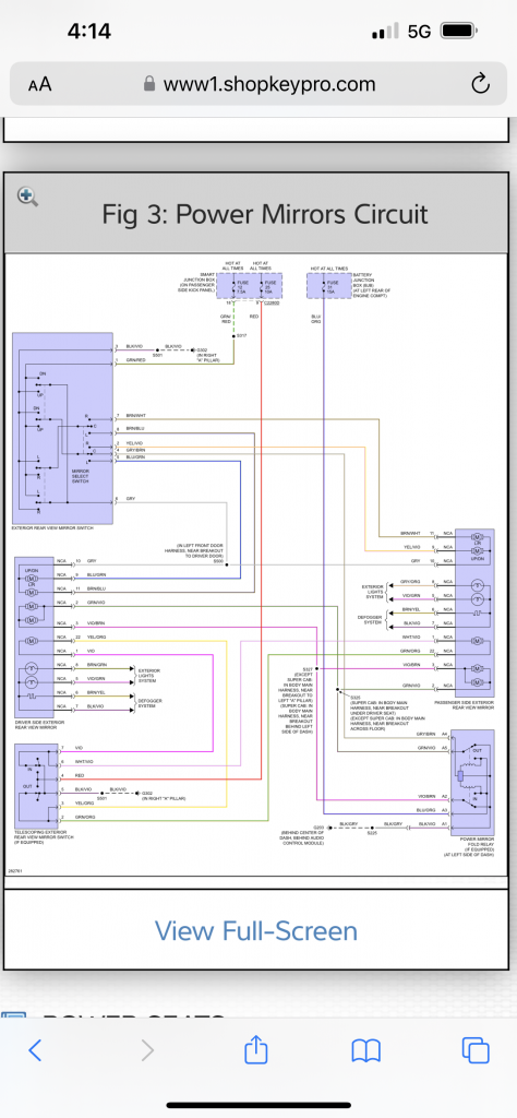

Ok so look at the connection in door jamb, sometimes not all of the wiring is in the harness, power mirrors are fed by fuses 12 and 25 in the fusebox on pass side kick panel, power fold is fed by fuse 31 under hood box. May be wiring missing in the dash harness that feeds and connects the doors
If that is the case is there a way to make this all work?
Thanks
Carlo
Racer71
May 23, 2021
75
12
You could add in the missing wiring, it would take a bit of work, but easier than swapping dash harness.
