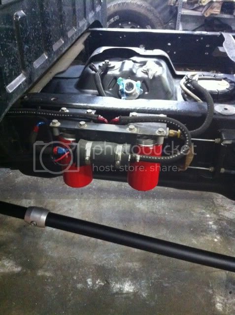

buy the kit from strictly its cheaper and comes with all the hutch and harpoon stuff pkus hoses and clamps and such for the easiest install, its what im running and its working good
91turbogsx
1,554
Gardner MA
My stock pump has been running in this system for 2 years now.
TARM
2,439
