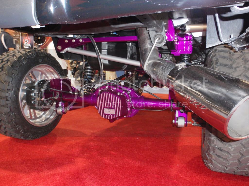

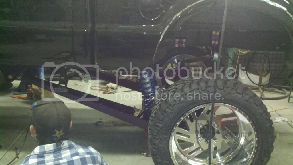

Things have finally slowed down and I have some time to show you guys the suspension stage of the build!
In just over 3 weeks, Precision Metal Fab designed, built, assembled and delievered to SEMA what is in my opinion, the trickest suspension systems and trucks I have ever seen.

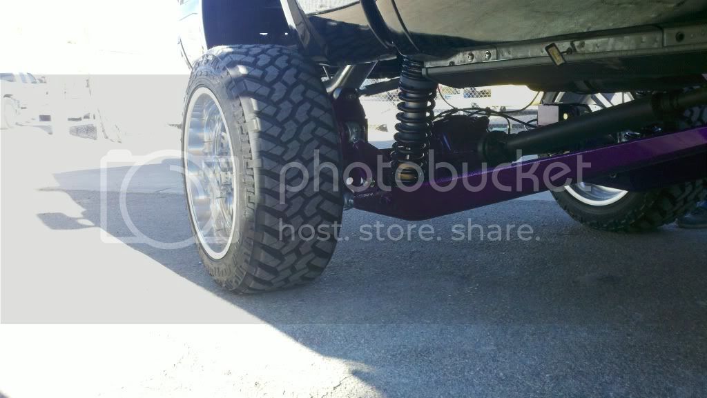

The Trophy Truck inspired Long Travel suspension uses custom tuned 12" Travel 3.0 Coilovers at all 4 corners and features 12" of travel in the front with PMF Adjustable 3 link Arms and a massive 18.5" of travel in the rear with their freshly designed Trailing Arm set up.
One of the best parts of this was the fact that I was able to be there and lend a helping hand where ever I could and in return, be able to see all that really goes into actually building a top of the line lift. Trevor is an unbelieveable welder, perfectionist, and has become a great friend. I could not be happier with the truck and the experience I had.
I was able to take quite a few pictures through out the process, so enjoy!

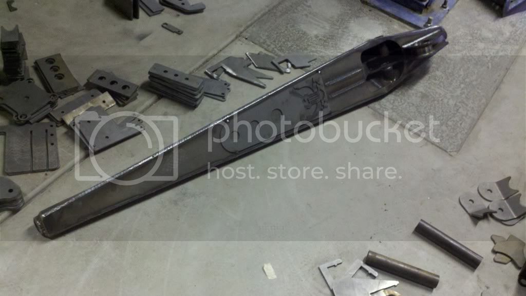

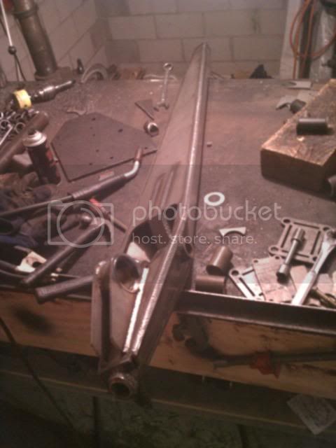

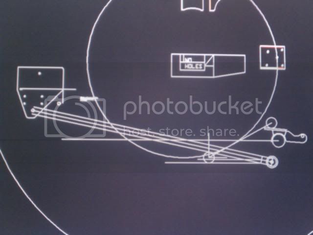

Early stages of design

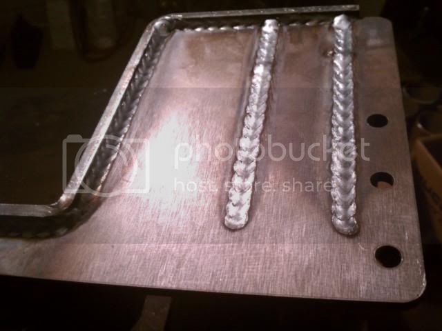

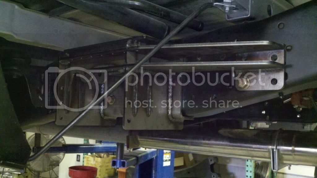

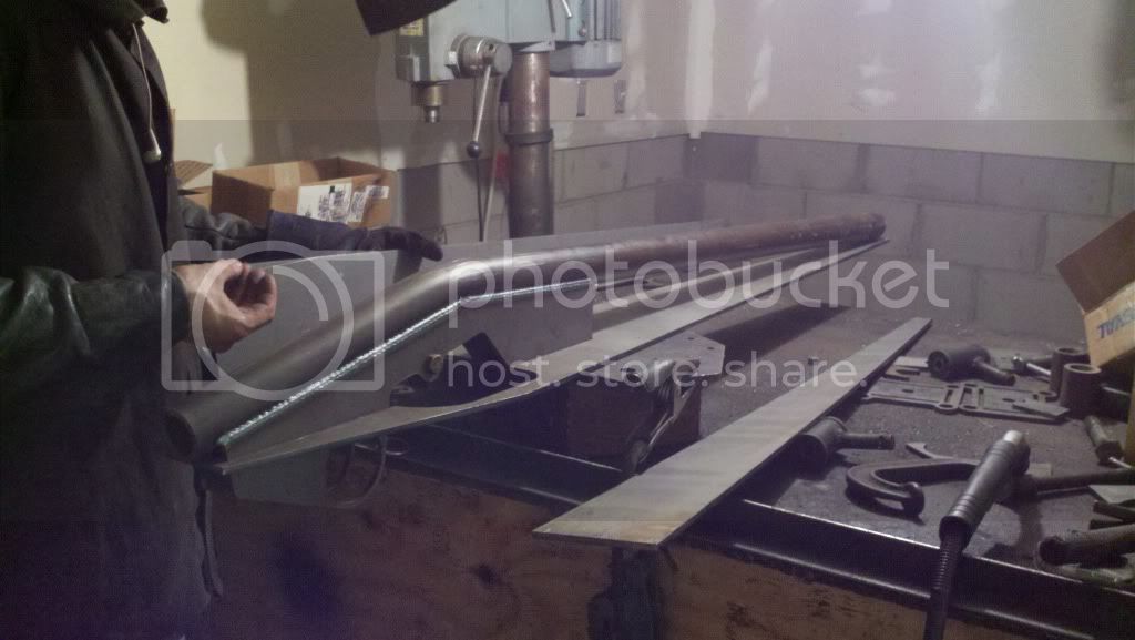

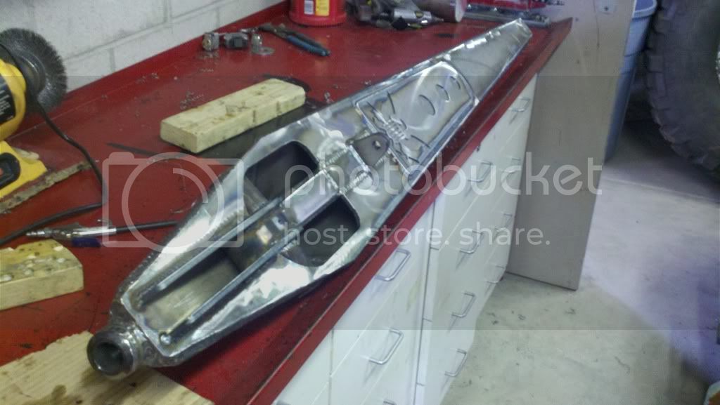

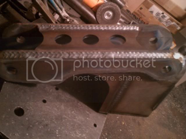

beautiful welds
left rear coilover mount

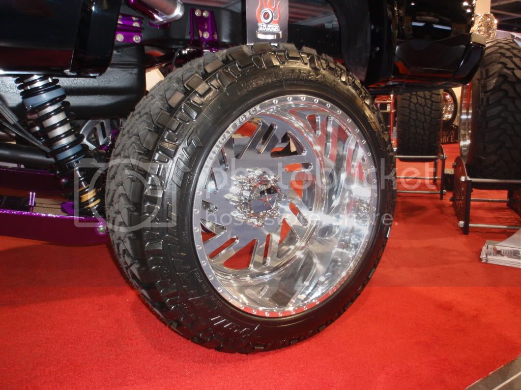

Those wheels are slick, I wish I could get some like that in 20"
The whole truck is really nice, I am not a big fan of the cali rubber but everything is very nicely done.

The wheel is a 24, so for now it is either 38/13.50/24 Trail Grapplers or 40/14.50/24 Interco M16s... so I am somewhat limited until Toyo Releases their 40/24 set up
plus the truck has so much travel that it can actually compress to being 2'' lower than stock... which manys even 38s can make contact with the fenders.
