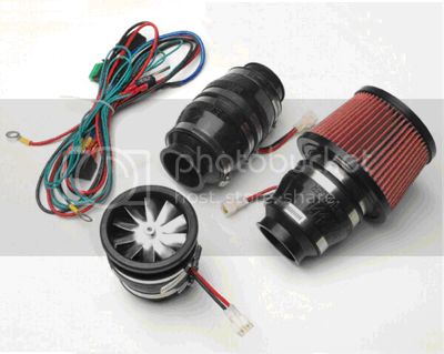

Considering the pump we run on our flow bench would like a 3 PH motor to drive it I find it difficult to believe you can add a hpop to your system that is driven by a measly 13V

When I saw all I could think about was one of these....
