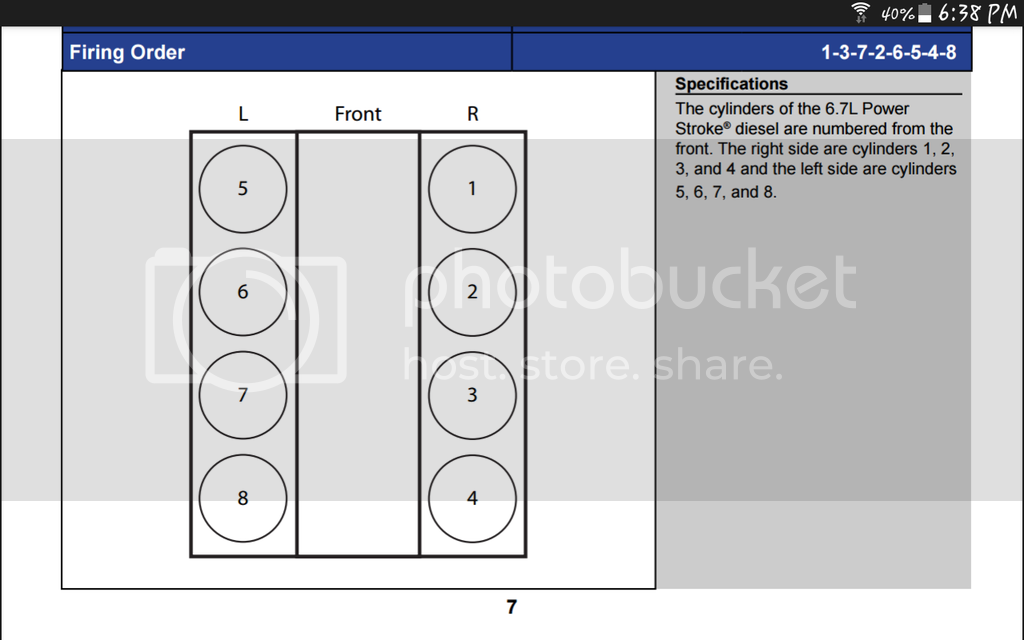

I have searched online and using our search function to no avai. What is the injector/firing order for our trucks?

Found that but didn't want to assume which side the started on. Being that I came from a modular motor in the mustang that had a reverse firing order.

the driver side (left side) is 5 6 7 8 numbered cylinders and the passenger side is 1 2 3 4

I lied to you on that. Driver side front to back is 5 6 7 8. Passenger side 1 2 3 4.
I was looking at the wrong document. I'll get a pic for you. Sorry about that.

Here is a pic for reference.
