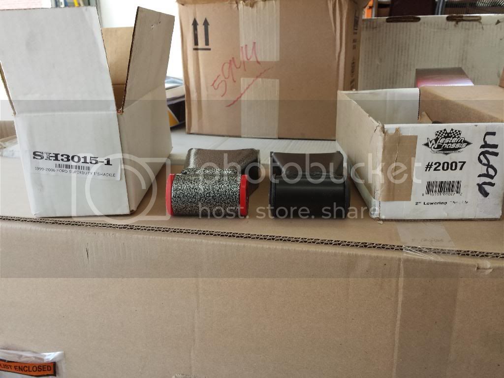

Ok guys. I have researched this for a week now with alot of mixed opinions. Here is my results. Djm makes a shackle for 99-2007 f250 and it is advertised as a 1" drop. The measurements of the shackle confirm this. Now, I was dead set on a true 2 " drop shackle but it appeared most people advertising a 2" was actually not a 2" shackle. So I came across western chassis. I called them and finally found a true 2"shackle. Part #2007 for 99-2007. Works on 08 up as well. They pulled them and read me the measurements so I could verify. Looks like I will have about 1/4" between the shackle and the bed when I'm done. This should achieve the amount of drop I need on this 2wd without pulling leafs. I will post pics before and after as soon as they arrive.

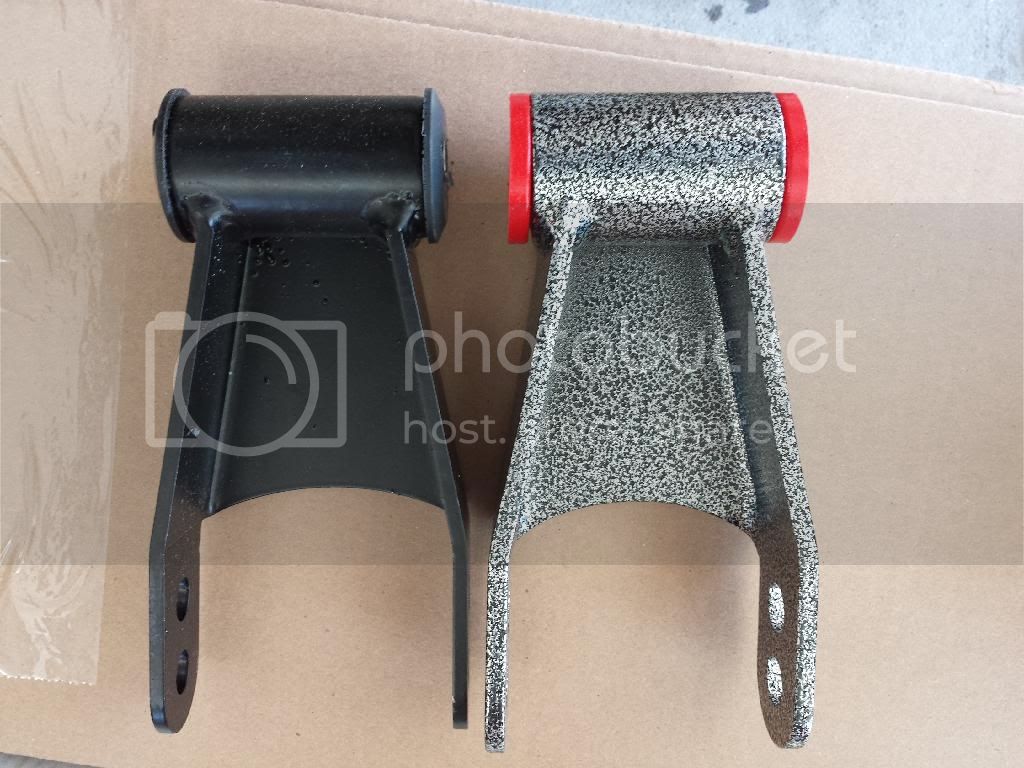

Well guys i can confirm the part # for a 2" drop shackle from djm that does work on a 2008 f250 or 350. It #sh3015-1. It is the same shackle that fits the 99-2007. They are listed as 1" drop which is incorrect. The shackle is almost 3.5 inches longer than stock. I just received these from summit racing and they are very high quality. I will take measurements before and after install and report back.

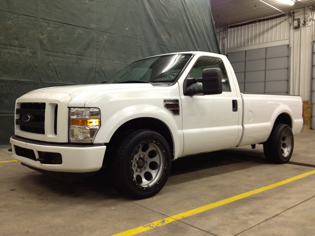

Well. I figured I would end all of my wondering about lowering shackles on a 2008 f250-350. I ordered the two only sets made that claim to fit a 99-2007 f250-350 truck. Here is what I found. Djm shackles are far superior with bushings and thickness of shackle. As thick or thicker than stock. Now the western chassis are thinner than stock. Had rubber bushings that had fallen out in the box. Very economically made if you get my drift. So I installed the djms and the fit was perfect. Had a 1/16" of clearance from new shackle to bed. They lowered truck a true 1.5" and it rides so much better. Also wanted to add that i checked my pinion angle before and after and it was 2.5° before and 3° after so it really didnt change that enough to worry about. No vibrations and much smoother ride. So for all that were wondering. Djm do fit an 08 up with no isuues. Here is the part # listed below.

Like I said they are close but both sides had 1/16" of clearance. They do not rub. I inspected thoroughly after a drive down the road.
