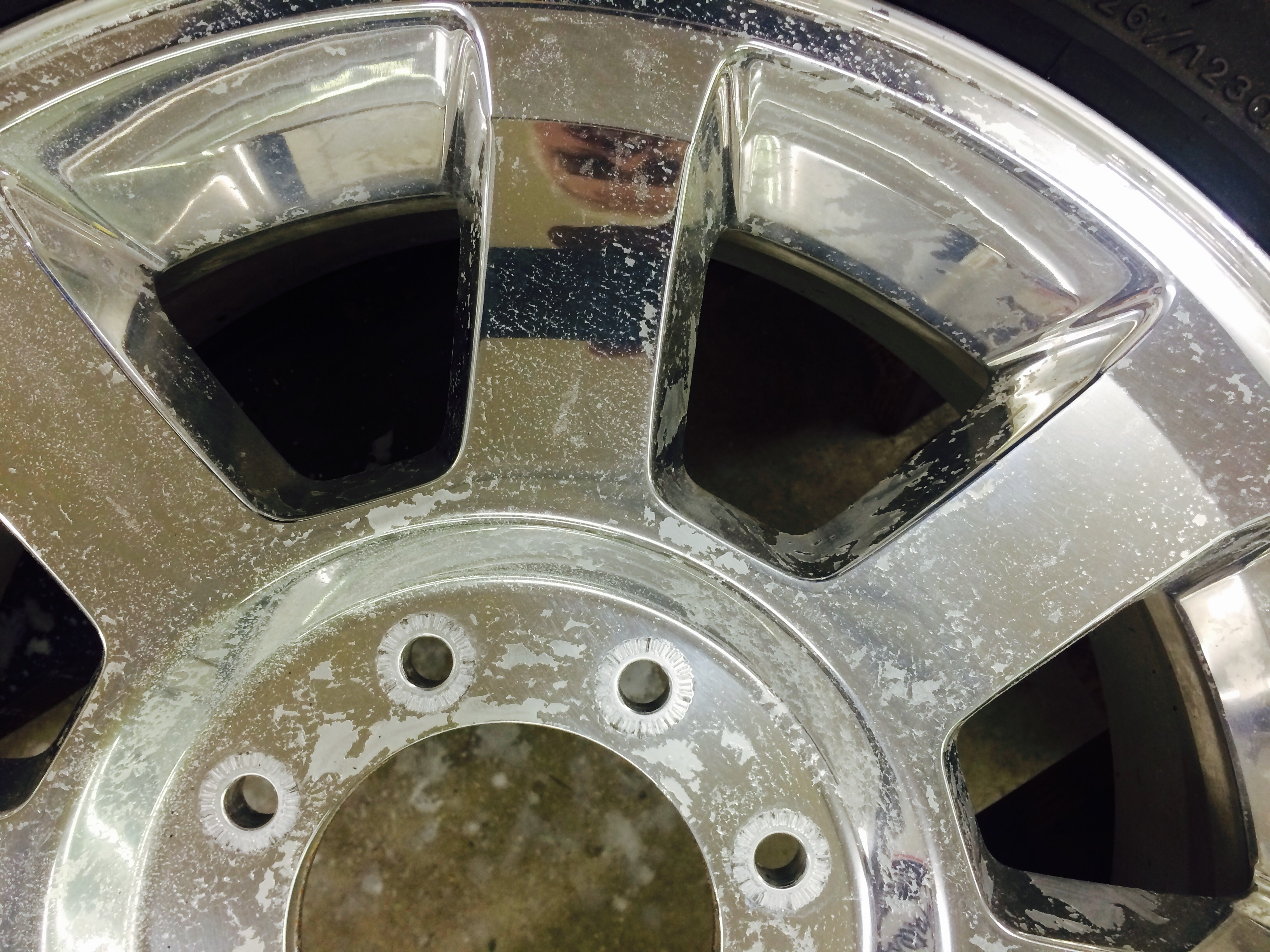

I was curious and am part way through stripping the clear off one wheel. ran out of daylight yesterday and will do another round of strip today. It's not coming off as clean as I'd like and may take some wet sanding before polish. I will say it's amazing how cloudy the clear was. The surface underneath is like a mirror -- with a little work they would look like chrome.

Here's a pic of what's left. I put the camera reflection in the spoke. All of the material that you could scrape with a fingernail yesterday is hard today.

Dang, that's looking good. I'd be a little gun shy about doing that, but the results are looking bueno.
I was surprised that it was mirror finished. Im going to play with it some more today, but Im expecting that I'll have to back up a little with some wetpaper and polishing time before going forward. For now, I'll be getting the spacers in the next week or so to make sure on the tire size (going 295/60s or 305/55) and I'll try some dip on a wheel as well.
Next to the 5 spoke 20x8s on the 6.0, these wheels are my favorite. Ive had the thought for awhile to do the argent color but the shiny is original and less money in the long run. But, im in them real right, so we'll play with them a little. More pics will be posted.

What were you use to strip them? Brush on or spray on? and a pressure washer?...
Used some old brush on stripper, one application, then the pressure washer. Some areas definitely need another coat, but much of the surface has these tiny bumps (feels like sand grains under your finger) that don't want to come off with the stripper and pressure washer.
Getting some new spray on stripper today.
