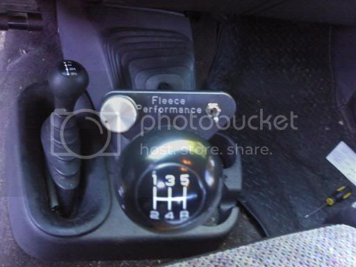

Over the years several times the idea of having a very responsive turbo setup either in a single or a compounded setup has arisen many times. On many of those occasion things get discussed like a supercharger for instantaneous response, small turbos for no lag, VGTs, etc..... Often I've brought up the compound setup off of my Duramax that uses a high pressure VGT turbo and about an 76mm atmosphere charger - incredibly responsive, actually can make boost at idle (1-2psi if I tune the vanes closed completely at idle), etc... For those that have not seen the setup on my Dmax - here it is:
