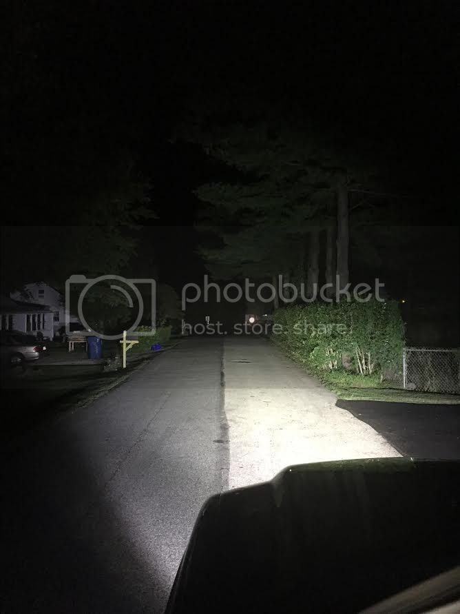

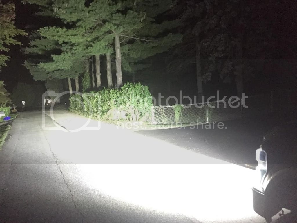

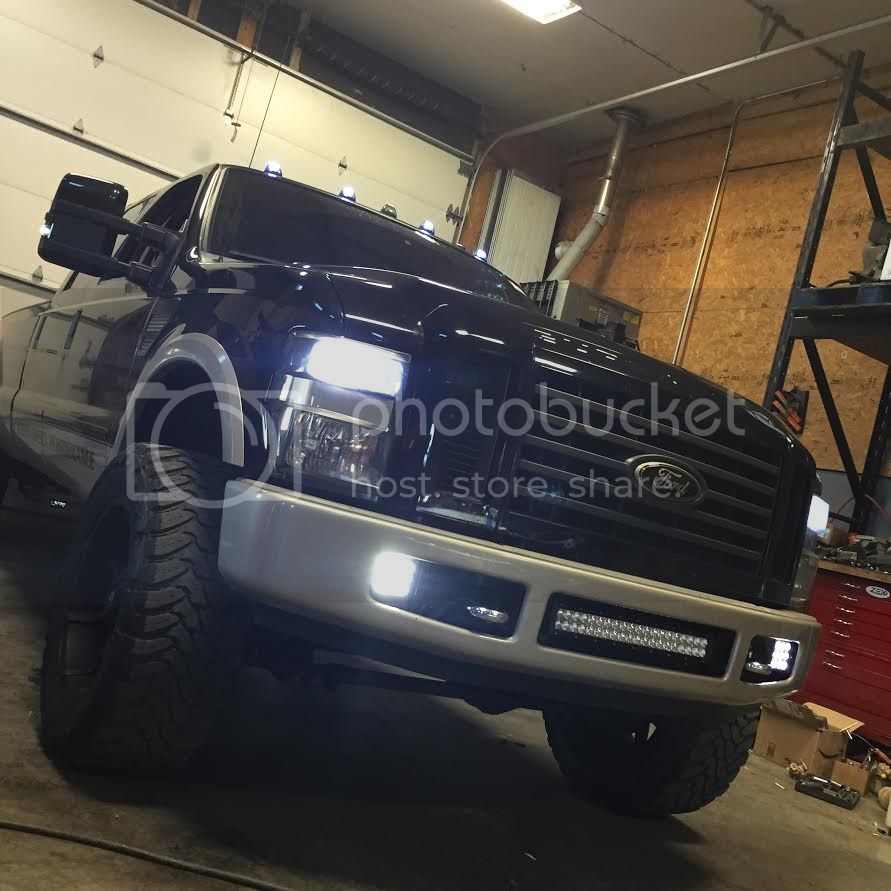

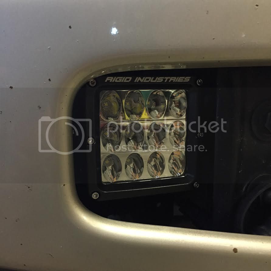

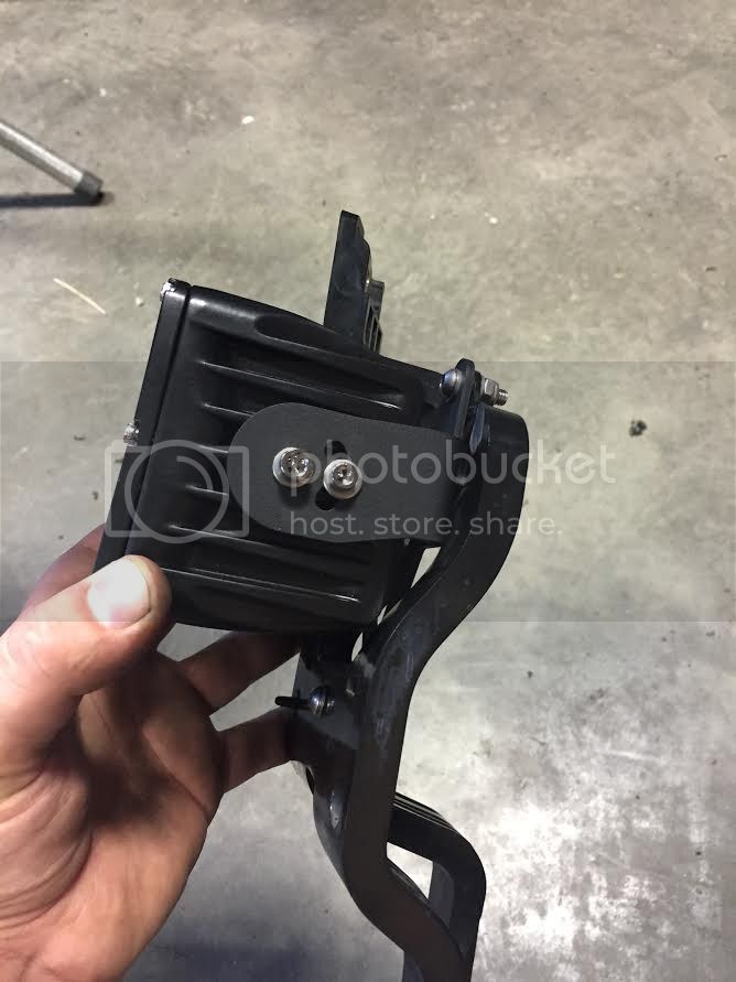

[QUOTE="Josh@DirtyDiesels, post: 1263361, member: 4097"] If you have any questions about them as far as options or pricing, let me know. He is, but I don't know his username and I know he said he doesn't get on much. They literally fit perfectly! The Dually's look a little small in the 6.4 but these fill the gap perfectly. We have a new one on the way... was waiting for that You would need the factory fog light brackets and hardware. If you wanted them to work on the factory switch, you would also need the wiring harness and I believe the switch, but I might be wrong on the switch part. If you don't care if they work on the factory fog switch, you could use an upfitter switch if you have them, or you could just run them off the supplied relay harness that comes with the Rigids. [/QUOTE]
