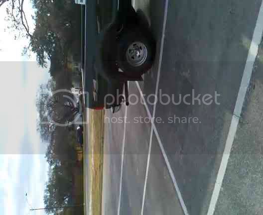

So as winter finally comes on, the truck is getting harder to start and smoking more white and blue smoke. Here's a video from this morning, it was about 50 degrees out. When it was 35 the other day, it made a large cloud of white smoke.
It also feels like it has a miss under light throttle at 35-45 mph when the torque converter locks. The whole truck will buck and jerk until about 45 mph. It seems to do this less in OD, but it still is noticeable. The white smoke goes away pretty quickly, but never completely clears up. Are these symptoms of bad injectors?

how many miles are on the truck, and I would say that, that video there isn't much smoke at all. but if you have a miss you need to go after that,
