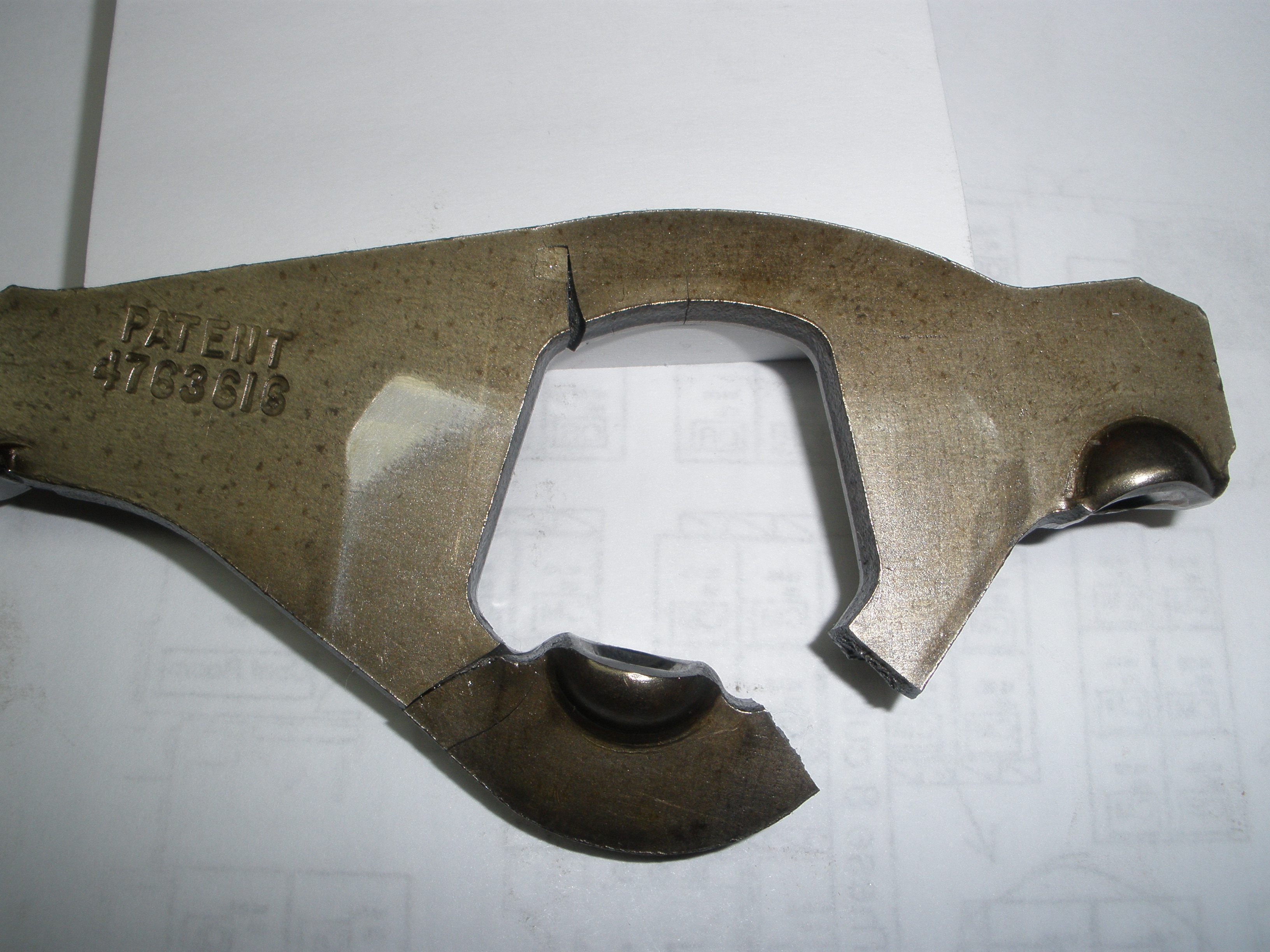

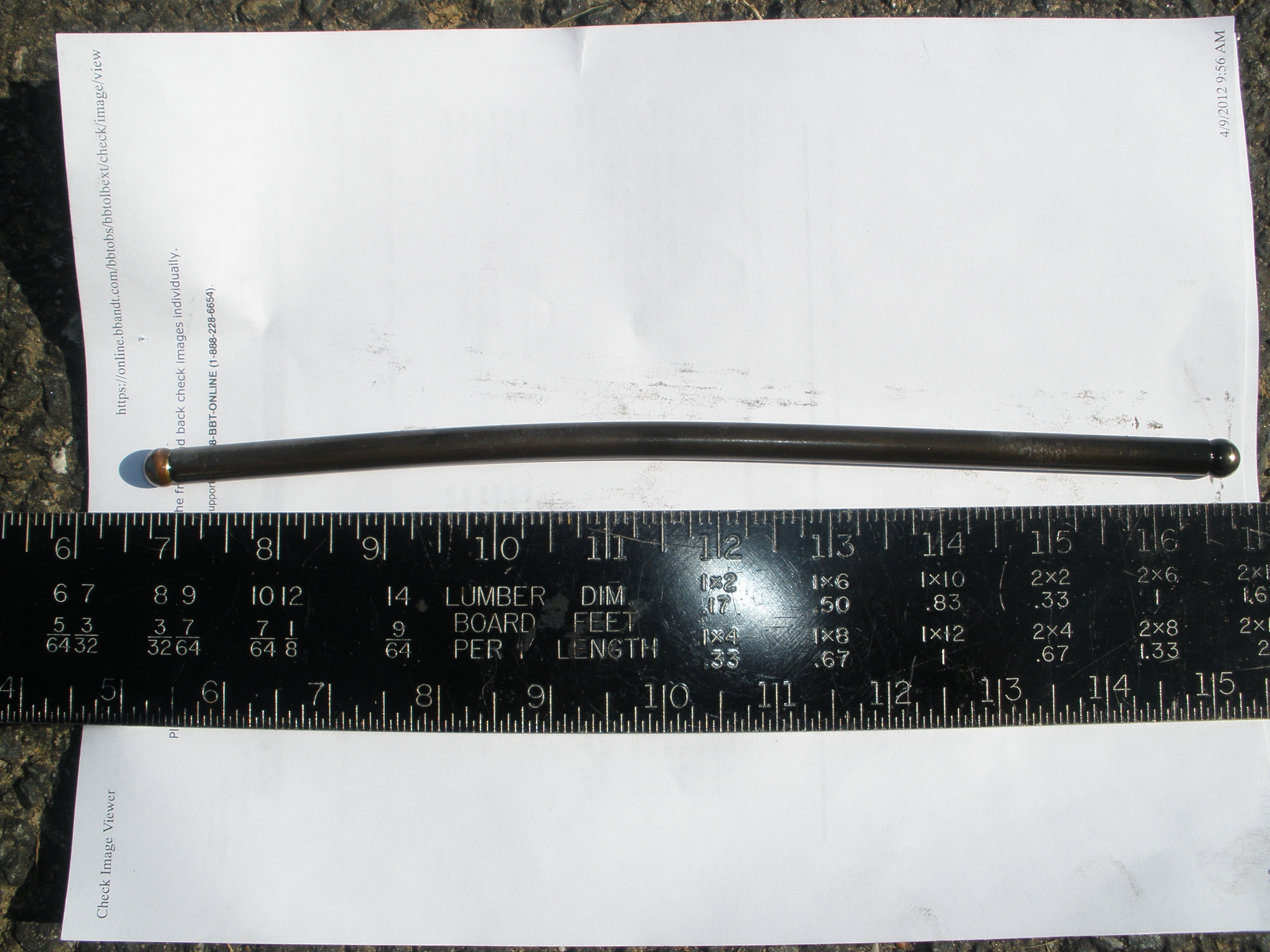

Well, this is my first time removing injectors and it was going along pretty smoothly removing the injectors on my 96 7.3 PSD until I got to the number 3 cylinder. My hand brushed against the rocker arm and it was loose. I then noticed that the push rod was loose and I could simply pull it right out of the head. Noticed a little while later that the rocker arm itself is cracked in three places. Not sure what to make of this.....anyone ever seen anything like this before? Any thoughts about what to do now short of having to pull the whole engine?

Strange you didn't hear it. Must have had some contact. I would just put in another rocker and push rod and keep truckin.

Somewhat common, but surprised you didn't hear it in the intake either. Like stated, just put in a new one and inspect for more bent pushrod, rockers on the other cylinders, you'll probably be fine.

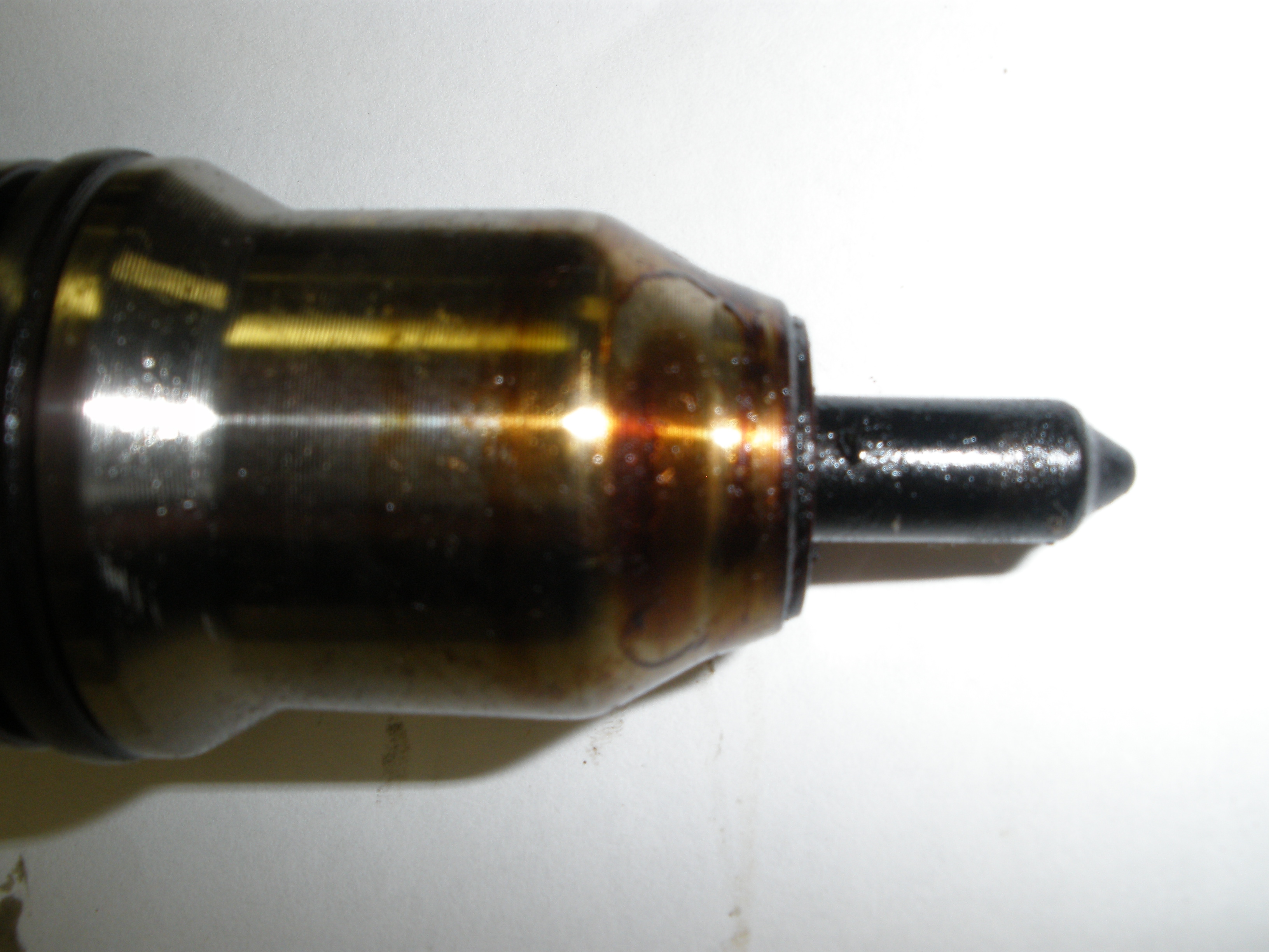

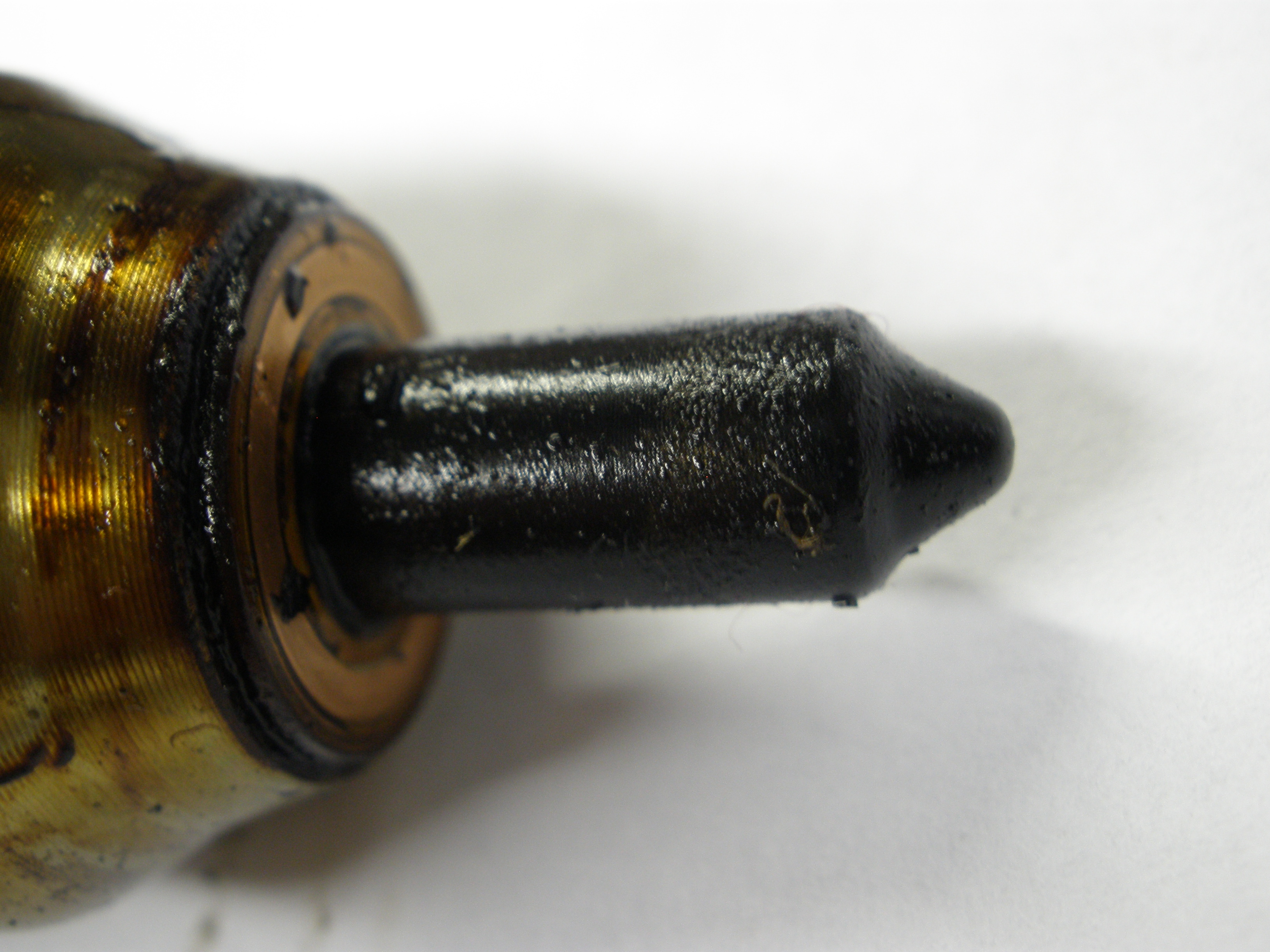

What did the injector that came out of that hole look like? Was the nozzle distorted/broken?
I think maybe the rocker arm damage did occur when I lost power and started smoking but I did not shut it down right away. I limped on to the off-road park which was probably another 8 miles or so. Wheeled the jeep at the park for a couple hours and then drove to the hotel about 10 miles or so. Never heard any noises out of the engine just ran like it was only on 4 cylinders and smoked like a locomotive.
I do not see anything out of the ordinary as far as the injector goes but this is the first time I have ever pulled injectors. Two pics of the injector from #3 cylinder below.
