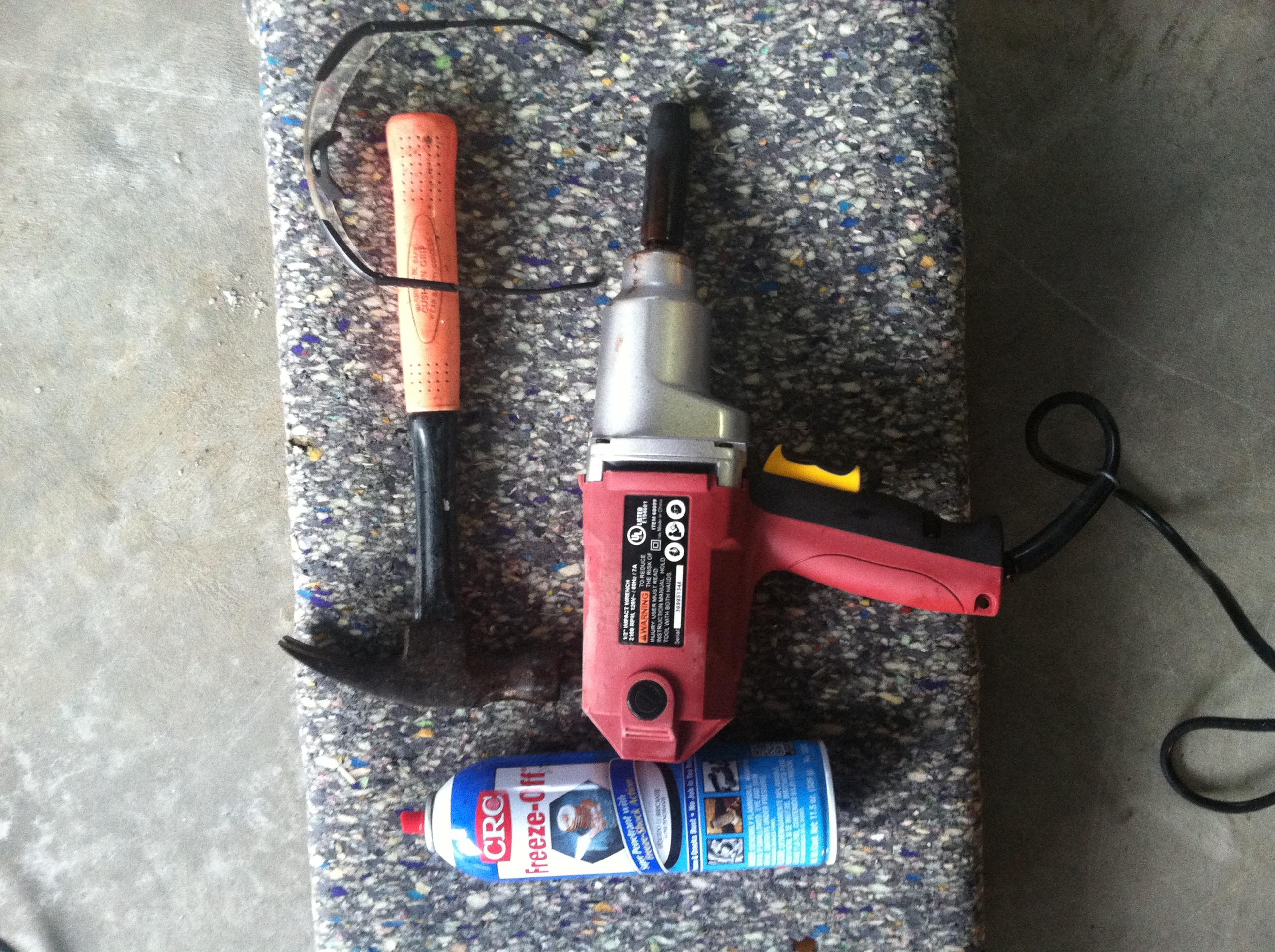

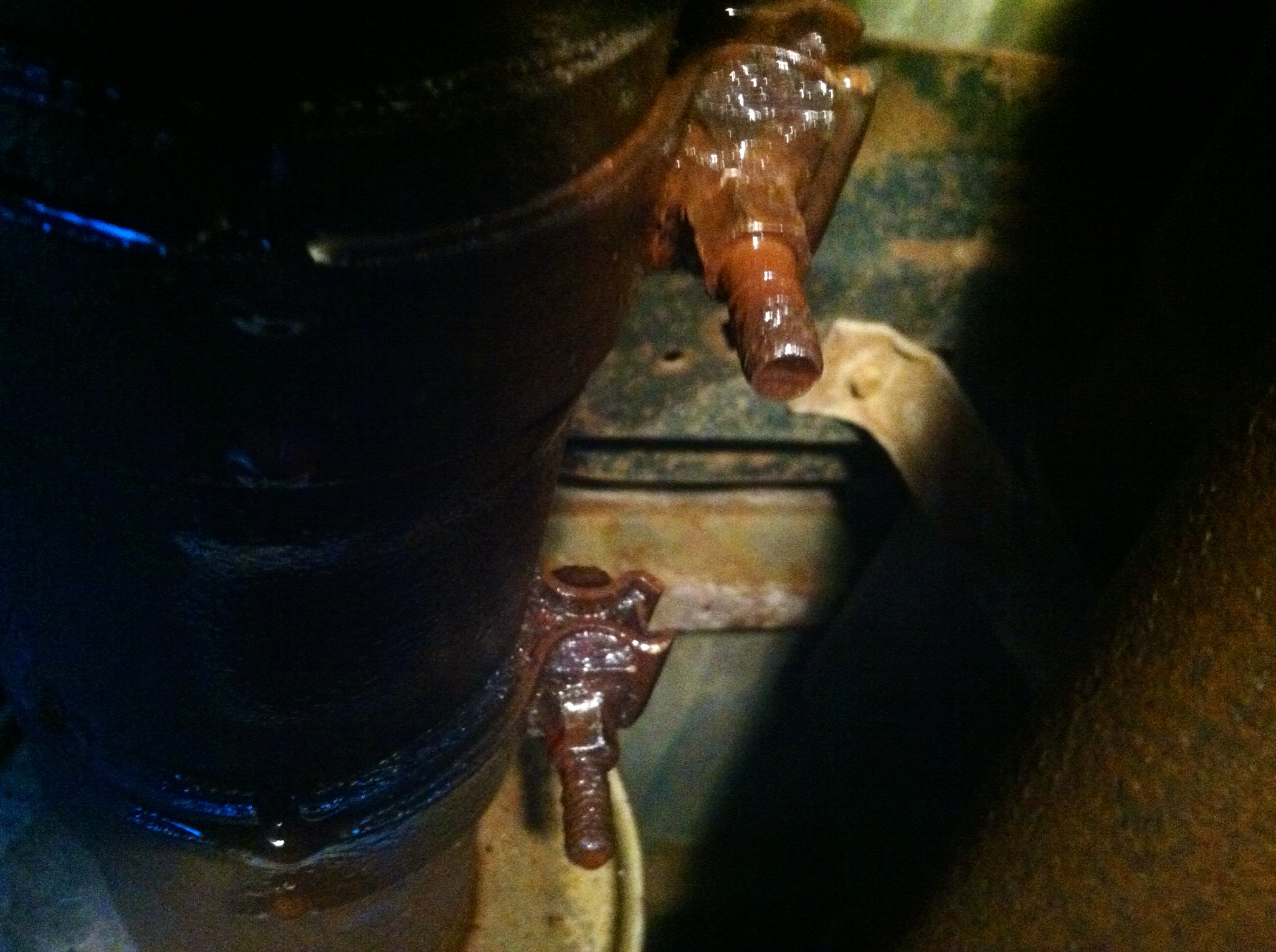

Started working on exhaust nuts to delete DPF and they were rusted to hell. Went to the internet and found nothing but horror. Decided not to let it beat me so I headed to Harbor Freight, bought some of this stuff and an electric impact wrench with deep well sockets. Spray... Beat with hammer... Tighten and loosen with impact wrench... Spray... Beat with hammer, etc, and sure enough... They zipped off. Success. Hard work and patience CAN pay off, lol.
