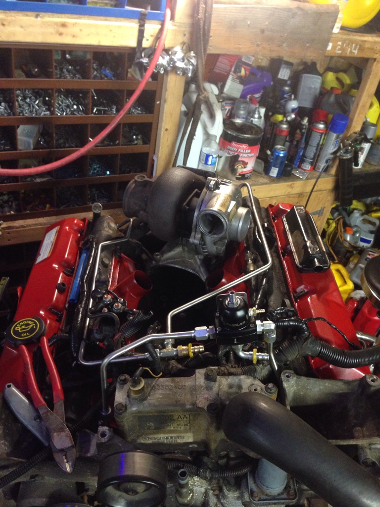

You need to replace the housing with a t4 housing then get a t4 up pipe kit .
Don't use a t3 to t4 adapter it won't work
Every kit made is for a t4 turbo. If you put an adapter in there the turbo won't be in the right location and your oil drain , down pipe ect won't bolt up .
You can buy the turbo but scrap the ****ty t3 housing,
