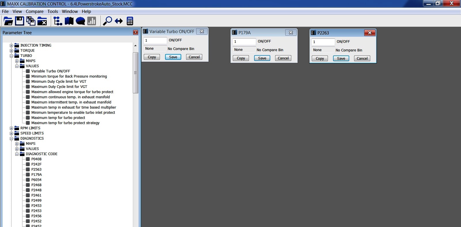

If you are running an H&S tuner you need to get the MCC custom tuning option so you can load custom tunes for your single turbo application. Withh MCC you can turn of the VGT programming & the codes you are seeing

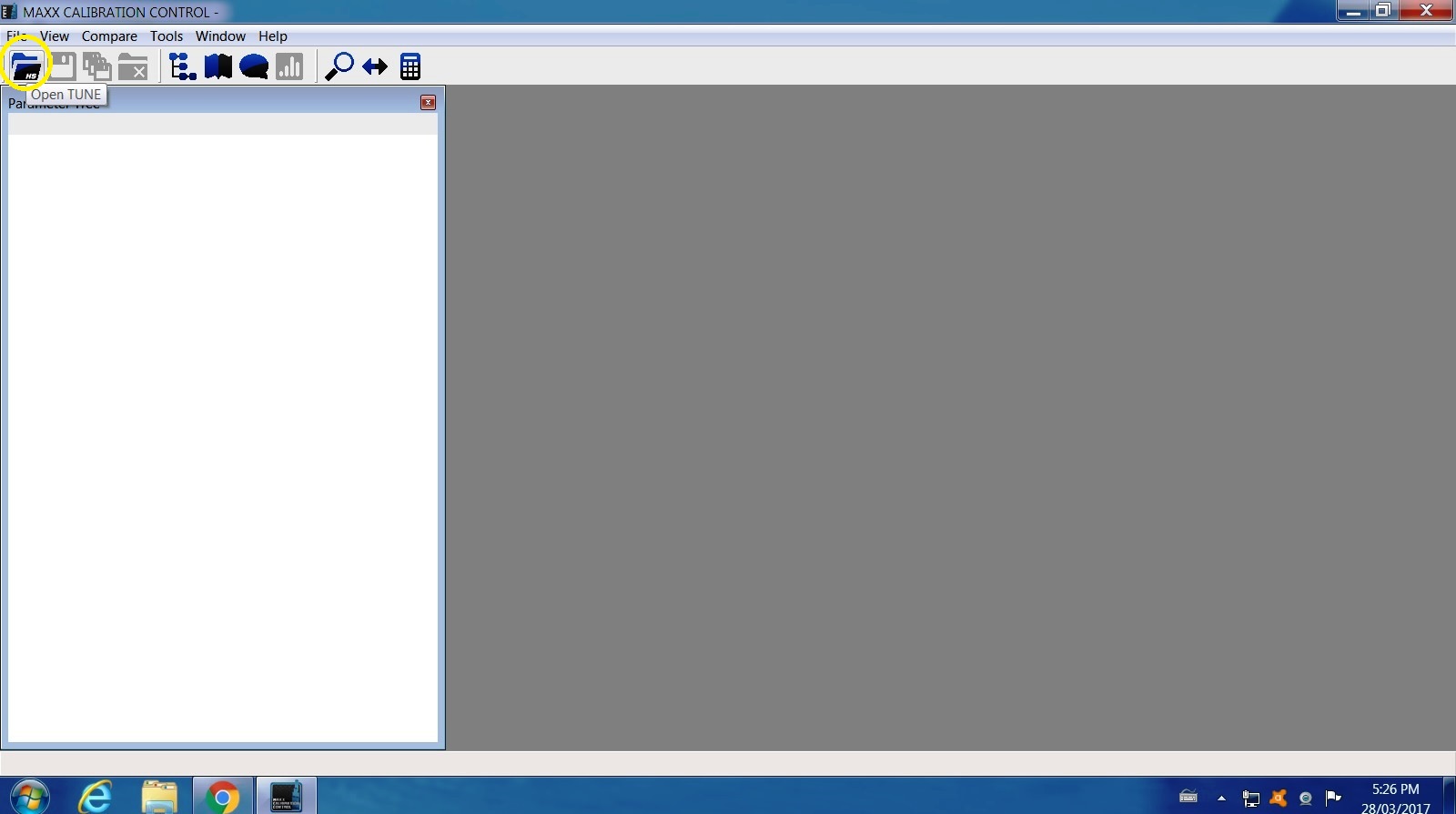

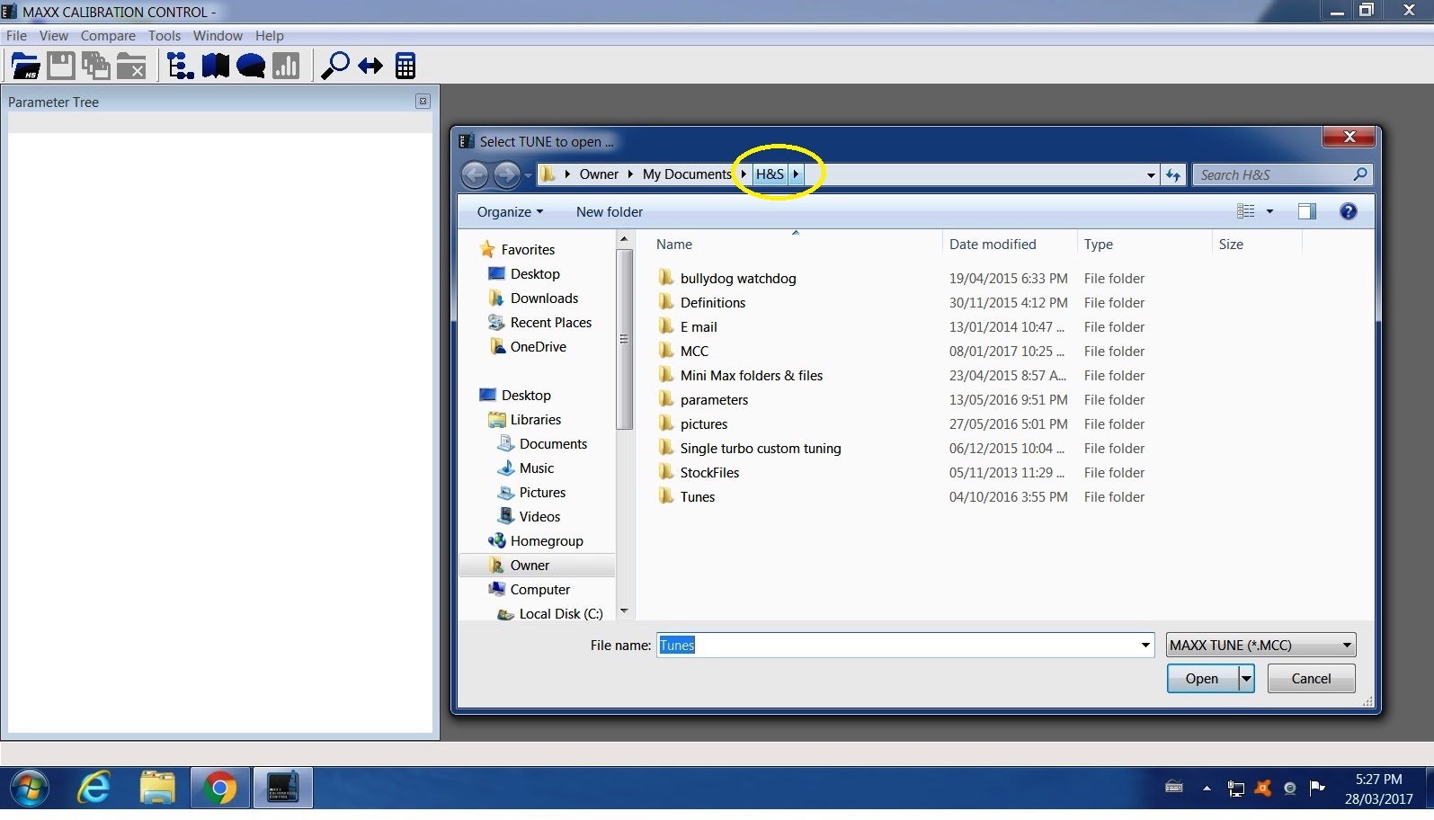

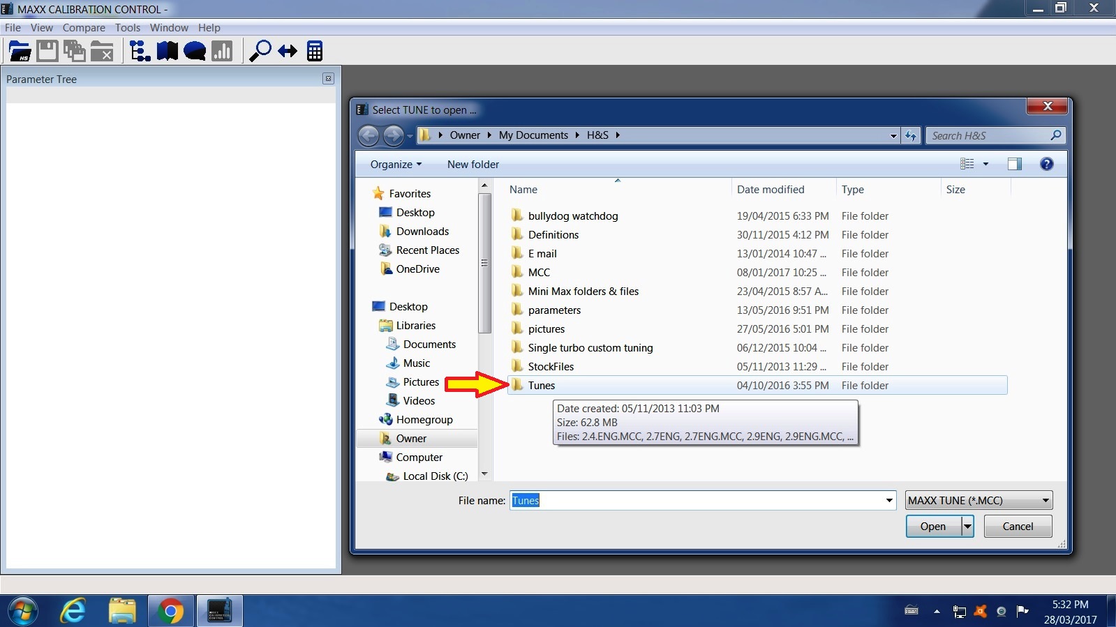

When you open MCC from your desktop, you should see a screen like the first picture. Click on the Icon in the upper left corner & that will open the H&S folder. In that folder there will be at least a "Definitions" folder & a "Tunes" folder.(in mine you see a bunch of other crap I've saved also) Open the "Tunes" folder & this is where you will save all the custom tunes you create or purchase. Yours should be empty until you export a base tune from your Mini Max onto its SD card & then cut or copy that tune from the "Custom" folder on the SD card to H&S/Tunes folder on your computer. Once that tune file is in the folder you can open it with MCC & change parameters as you like. Clear as Mud?
