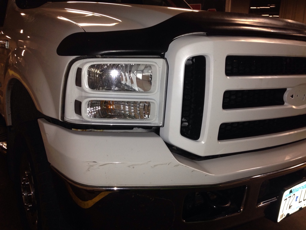

I didn't. Mine are a year old and still look great. Adhesion promoter and white krylon (I think)
