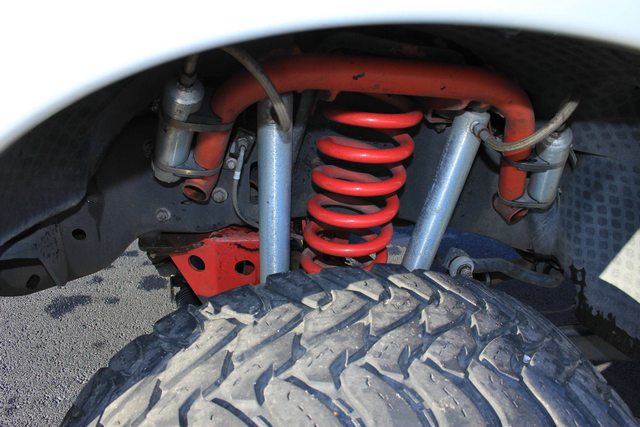

Okay so on my way home today I hit a speed bump a little harder than normal (not on purpose) and when I parked the truck about a minute later I got out and went around the other side to get my stuff and heard hissing. It seemed like it was coming from the reservoir for one of the shocks on the passenger side and then kinda stopped shortly after. Not sure if I poppedd the reservoir or the braided line. Doesn't really seem to be riding any different.
Should I go to the air pump and put more air in there or what? Whats the next step?

Most reservoir shocks are charged with nitrogen, so using normal air will not help.
Remove both shocks and see if they require the same force to compress, and see if they rebound at the same rate afterwards. It could be that the boots created a vacuum when the fully compressed and what you heard is air entering again.

no boots on 'em.
and I'm at school so I don't have a lift or jack or anything, I'm assuming I'll need to raise the truck up to get the shocks off?

Is it the front shocks or rear? If its rears just remove the bottom bolts and compress to test. If its the fronts, remove them and test.

They won't be too bad, they can be a pain sometimes if the shocks are really stiff.

Thanks gents, gonna attempt it tomorrow. probably just check the rears too. I need to to the steering stabilizer and I think those have been blown for a while. Might be buying a lot of shocks soon lol
