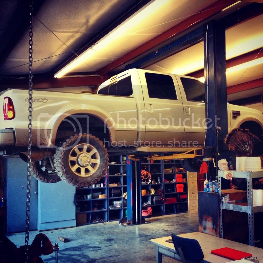

For all you who have/used a 2 post lift, what are you lifting points for the 6.4's?
I did the radius arms, and one arm all the way to the back of the frame and one to the front of the gas tank.

I used the frame front and back on the 04.
The dually I tried doing the same, well it didnt get off the ground. That is when I found out that it was in the 10,000# range, the rack would not lift it.

Truck hoist. Behind or on radius arms, and on spring perch mounts for rear. Or immediately in front of it if longer wheel base.
