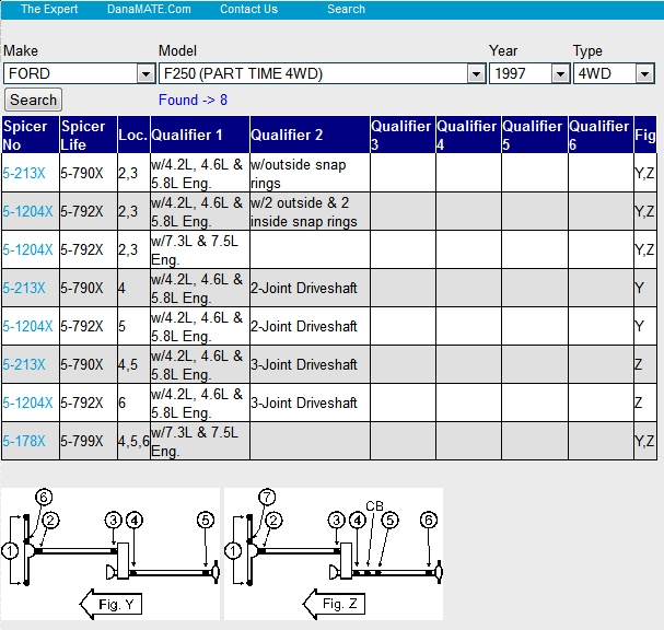

front shaft is not a regular spicer size
it is a ford specific size. part number 5-792x
it is a 1330 with 1/16" larger caps on at least two ends
rear is regular 1350 iirc
http://www2.dana.com/expertforms/dek350.aspx
that form will give you the info you want
